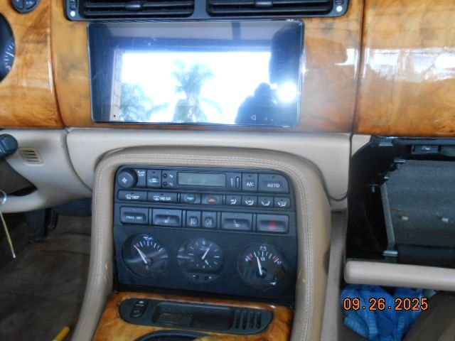

I have to go back and look at the wiring to the 3 gauge cluster. I installed an updated stereo system (Joying) and moved the 3 gauge cluster down to where the OEM radio lived.
In order to do that I had to extend the OEM harness to reach thebottom of the console. I did this by purchasing a used harness for the 3 gauge cluster to create the extension. I have to go back and see if I screwed up somewhere.
This is where I installed the 3 gauge cluster with the screen for the Joying stereo mounted where the 3 gauge cluster used to be.

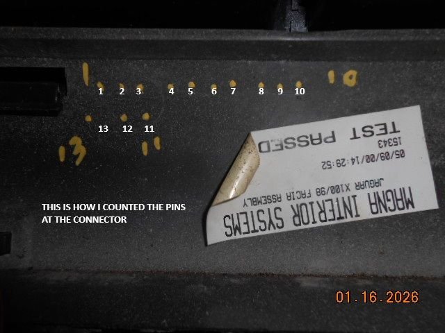

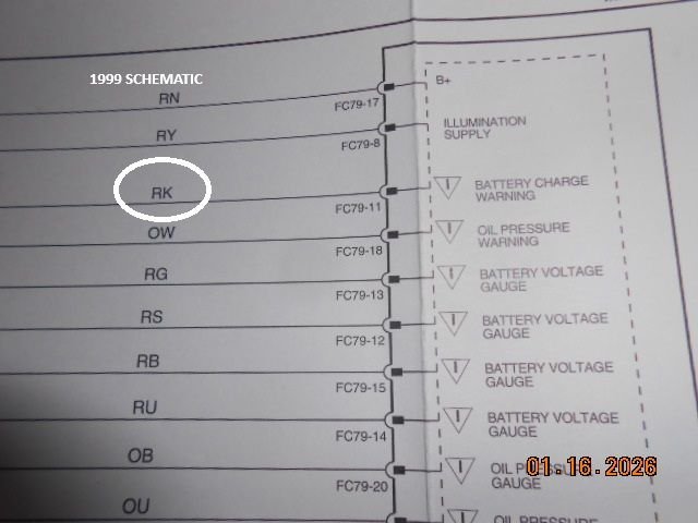

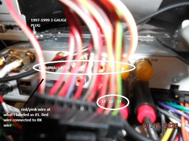

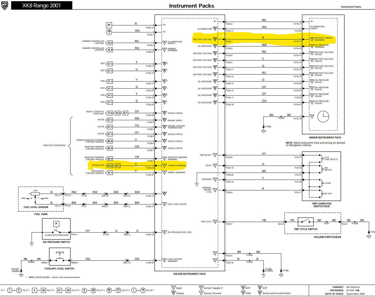

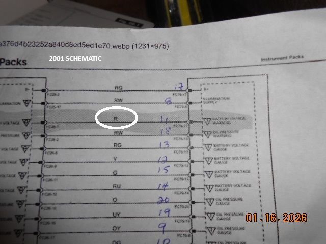

I honestly think I made a BOO BOO. The 3 gauge harness I purchased came out of a 97-99 XK8. The problem is that the wiring colors are different to the 2001 harness. I am also sceptical that the pinout at the 3gauge connector may also be different.
The 97-99 Electrical schematic shows RED/PINK(FC79-11) as the wire I have to deal with but it's located at Pin #1. I do not know which pin # the red wire(FC79-11) is connected to on the 2001 XK8
Does anyone have a pinout of the 2001 3 gauge connector or a clear picture. The connector has 13 wires in both the 97-99 XK8 and the 2001 XK8. My qoriginal connector was misplaced or thrown out when my grandson came by to help me clean up my garage, so I have nothing to compare the connections with.
97-99 3 gauge connector
97-99 schematic
97-99 schematic
2001 3 gauge schematic courtesy forum member
This numbering may be totally incorrect

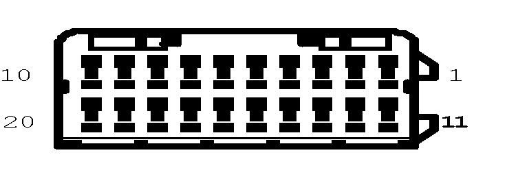

Here's the pinout for FC79 from IDS. View is female front:
Pins 1 - 7 are unused,
Pin 11 would be the wire Red on 2001, Red/Pink on 1999.
Hopefully you can work out from here, but shout if you need anything further. Jaguar seems to do this wire colour juggling every now and again to keep us on our toes.
If you're getting a charging error in the message centre on the main cluster, then I'd be suspicious of the alternator regulator (or its input to the cluster).
Old Jan 16, 2026 | 08:34 PM
RoverJoe's Avatar
Community Influencer
Joined: Oct 2025
Posts: 433
Likes: 164
From: South Florida
The schematic I posted was for a 2001, it should have everything you need
I attached the segment of the manual as a PDF if you want to blow it up/print it out.
