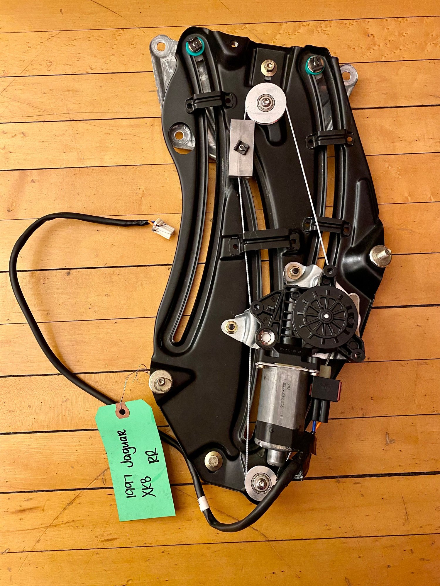

These crappy Ford regulators (I have a rear quarter window regulator from my SN95 Mustang and, while they are not identical to the Jag, they are very close cousins) are made with plastic pulleys with no bearing. The brilliant design has a cable winding and unwinding on a spool attached to the motor. The only thing keeping the cable straight and aligned with the spool groove is that crappy plastic pulley. When it wears the pulley starts turning at an angle, the cable gets tangled in the spool, and the window grinds to a halt.
Regardless of who does the work, I recommend sending the regulator to Power Windows Repair AZ. They have an eBay presence. I sent mine to them and got it back within a few days. The plastic pulleys were replaced by metal posts, and metal pulleys with bearings. This thing is as sturdy as all get out, and will outlast the car.

I agree about Power Window Repair in Phoenix, AZ doing excellent regulator rebuilds. They rebuilt both for my 97.

That rebuild is nice looking and not sure how my local guy will deal with it. But from that photo it is a perfect demonstration of something that should be a simple device is hugely more complicated than it really should have been what with the pulleys and cable.
Great pic! I took pix of the process when I did mine and apparently had a massive brain f*rt. I completely forgot to take a pic of the refurbished regulator. I may steal your pic!!

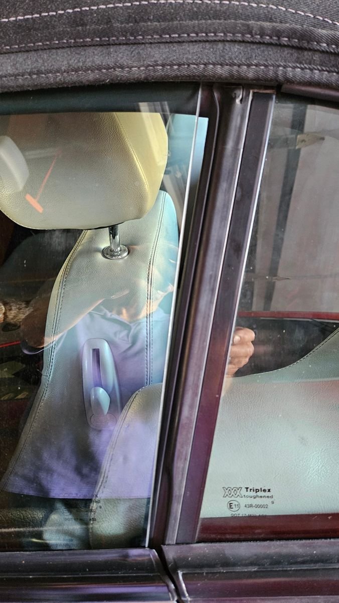

Well bit the bullet and had new regulators for the rear quarter windows installed ant the parts came from Moss Motors (I believe). The quarter windows now work like a charm but now I have a gap between the main window and the quarter window on both sides, but the driver side is the larger one. I assume the problem is not with the quarter windows but maybe adjustment of the main windows? I went through the "reprogram" of the windows by opening and holding and closing and holding and this did not solve. The gap happens at the very last movement of the main windows where they sort of move forward.

It looks to me like whoever installed them didn't adjust the rear regulators properly. You have to bolt them in loosely, then roll the window up and futz with the bolts and the stop. The roll it down and up and recheck. There is a little lateral adjustment, and quite a bit of vertical adjustment. I suspect they didn't test the vertical adjustment. They can't be adjusted now without disassembling the interior, speaker, etc.

There is a relationship between the front and rear windows.
The fronts can be adjusted slightly as to 'tilt'.
There is a horizontal bar to hold the regulator in position and the screws can be adjusted.
Sometimes they loosen and the assy needs to be re-adjusted.
Playing with BOTH the front and rear will get everything lined up.

When I picked the car up the top was down and I suspect they failed to see how things lined up with the top up. I alerted the shop when I got home and raised the top and he said it should be a relatively easy adjustment. The shop has been very fair in the past and expect they will take care of me when I bring it back in.
