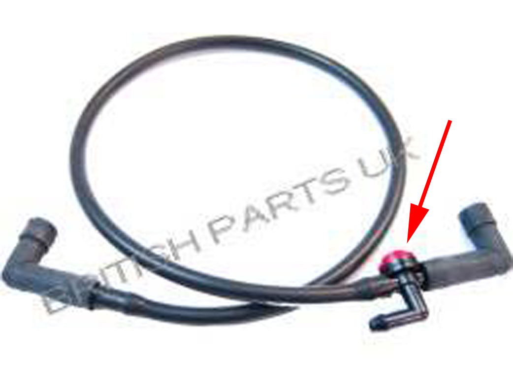

Old thread but I finally took the time to peek under the plenum. It looks like this plastic (of course) tube splice piece broke which is why I am not getting water to the washers. I am attaching a picture that shows the exact piece that is broken but it looks like I have to buy the entire stupid piece for about $40. The part number is GJA8970AE. Does that sound about right or is there some generic plastic tube splice piece that will work from Autozone or someplace?

Thats an anti-backflow valve so the fluid stays wicked up the tubing so you get spraying action as soon as you hit the button and I suppose it keeps the pump primed also. A regular 3 way T should work but it may take longer for the fluid to get going..

Hey Ted--I suspect this piece was actually broken by the last place I did servicing when they presumably removed the plenum to try and track down a clunk. These types of little plastic T-fittings are very delicate especially as they age so I guess I can't really blame them.

That is broke on mine. I am just gonna get a T to fix mine. So what if it takes a little longer for fluid to hit the window. I would not waste your money on getting it from Jag. They are a TOTAL rip off. They wanted 19 bucks a pc for the 5 screws that hold the water pump on the car. That did it for me, I will NEVER use a dealership at any cost, paying those prices is a JOKE.
