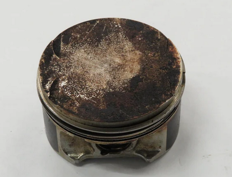

Whelp, it looks like it's the end of the road for this girl, at least in my hands. I scoped the cylinders, and the valves all looked good, but then......
I'm guessing the mixed up exhaust cams prevented the exhaust gases from exiting the cylinder and melted/holed the piston. There's some slag on the cylinder walls as well. There is evidence of a small amount of valve/piston contact in another cylinder, but the valves looked visually OK:

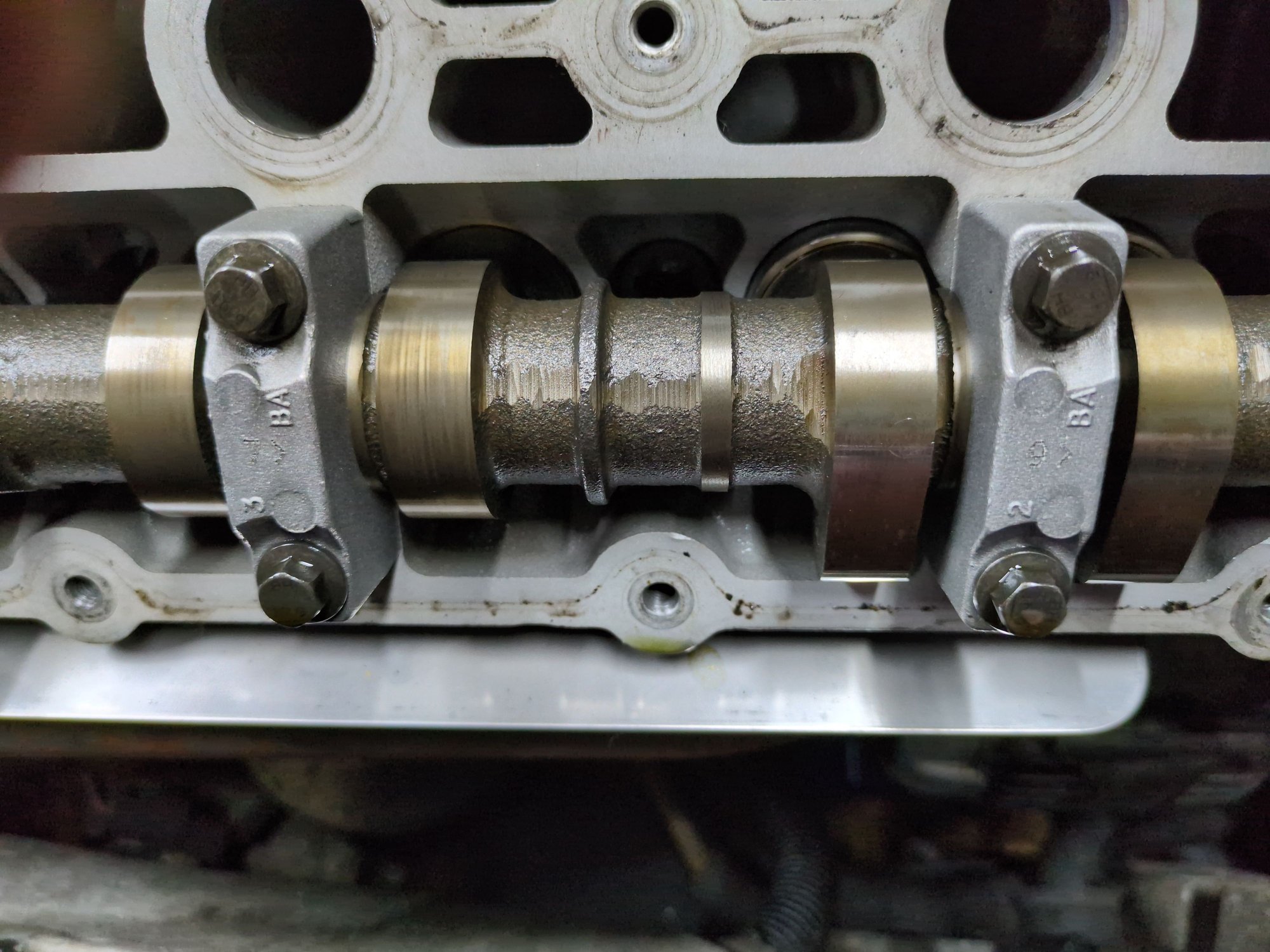

Oh - a follow-up to the cam cap issue: they are all correct, except for the 6 and 9 on the cam with the holed piston were reversed. I was reading the wrong numbers on the caps.
Incidentally, the cam in question looks like this, which seems weird:

Well, FWIW I've decided to rectify the cam issue and see if it runs. Talking with my Jag friends, there is consensus that the visible damage in the A3 cylinder is a) from the original timing chain mishap and b) not bad enough to prevent it running.

I'd agree, since you noted that the valves now look OK, that they can't have caused the damage. I believe that the marks you see in the second pic. are machined when the pistons are made.
You can see them on the LHS in this pic:
