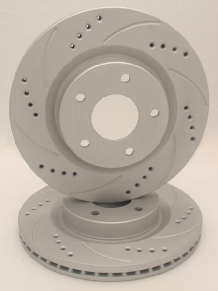

I am going to put these on mine.
I had slotted ones before on the last xk8 and liked them
