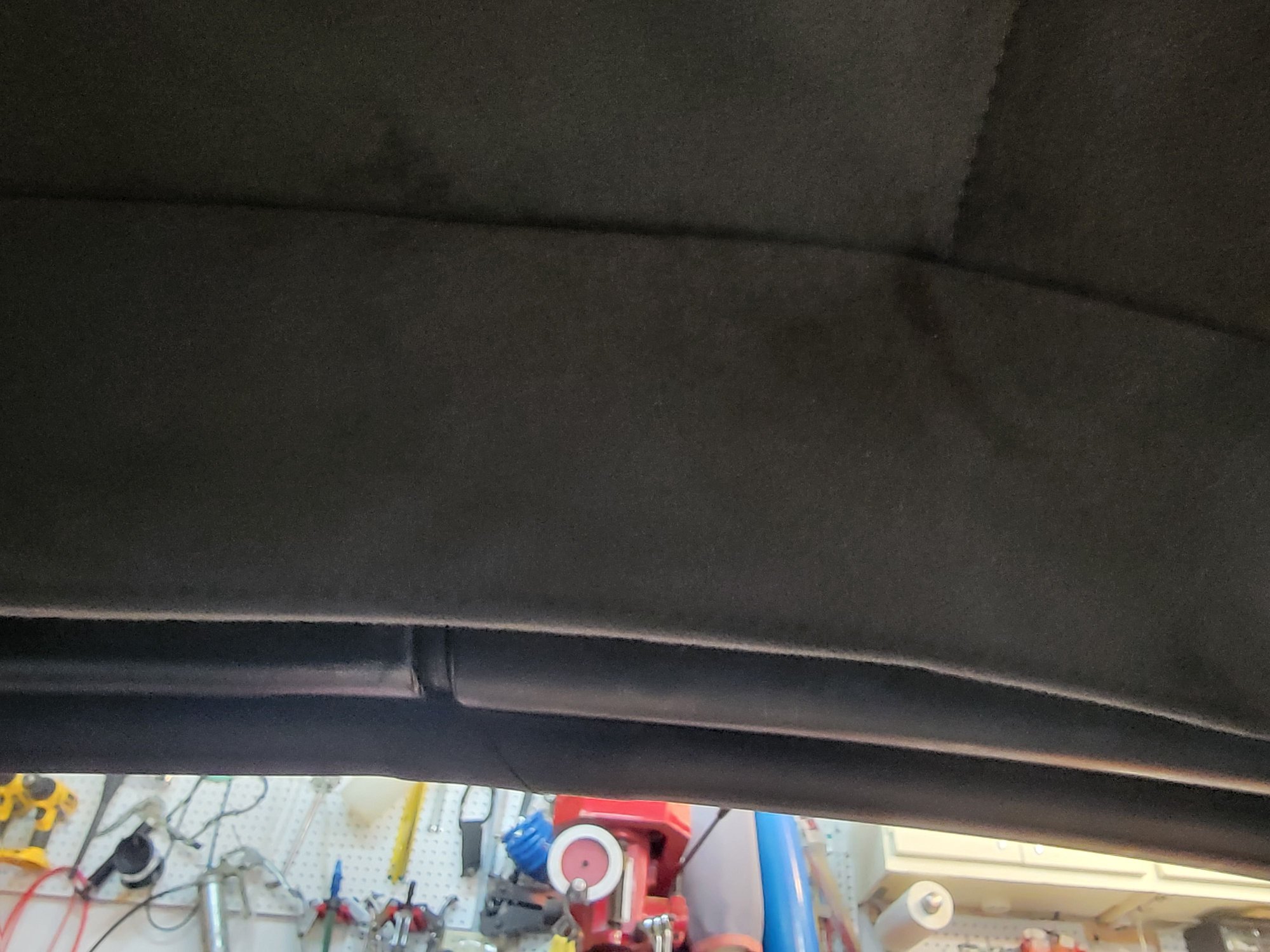

The drip comes from just forward of this joint.

hmm okay. that one is new to me.
is there any cut you can locate?

I may have discovered the reason for the leaks. There is a narrow lip component to the outboard aspect of the rubber roof-to-window seal. This narrow lip appears designed to cover and seal the outer aspect of the metal roof frame. On mine, this lip was partially folded under the frame causing a buckle in that lip that might have compromised the water seal.
I have unfolded this rubber lip and touched it with a bit of heatgun after which it appears to be laying flat again.
We shall see how it goes next rain... 🤪

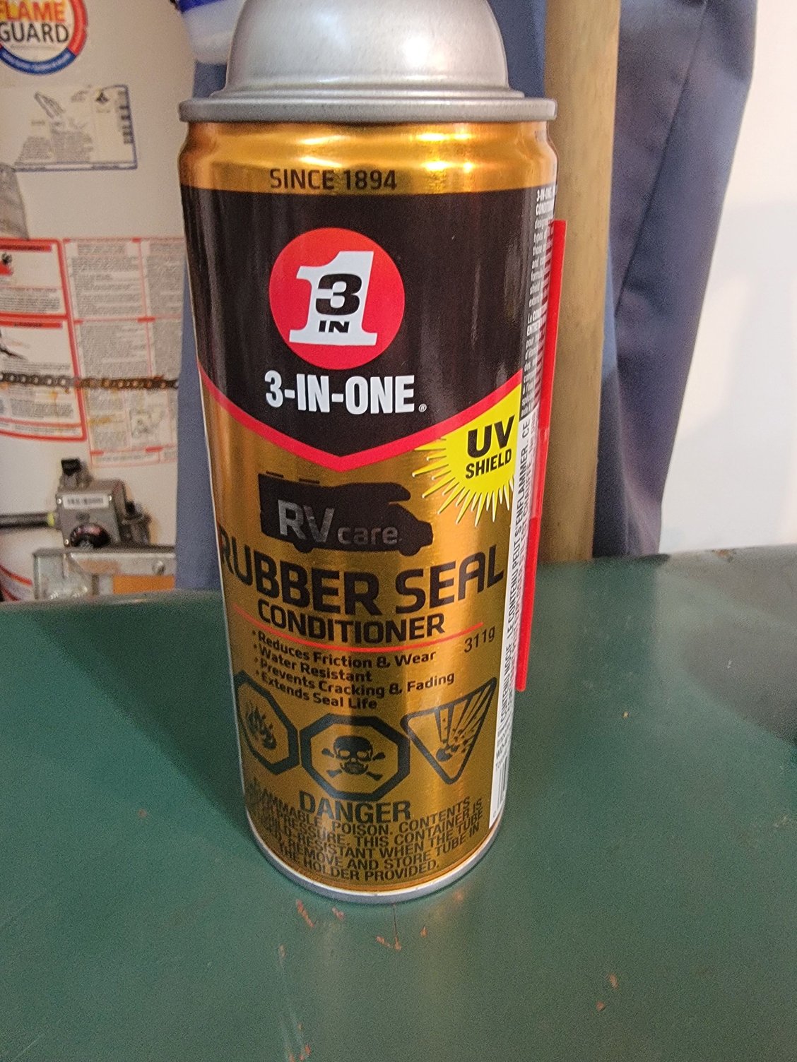

The "clean and treat" process has done the trick. I washed down all of the rubber seals on the convertible roof frame and on the door using a solution of water, dish soap (detergent) and isopropyl alcohol. I was amazed at the amount of "black stuff" that was lifted!
I then treated the seals with a "rubber seal conditioner" made by "3 In One".
No more leaks.
