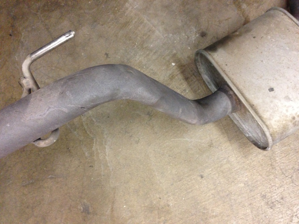

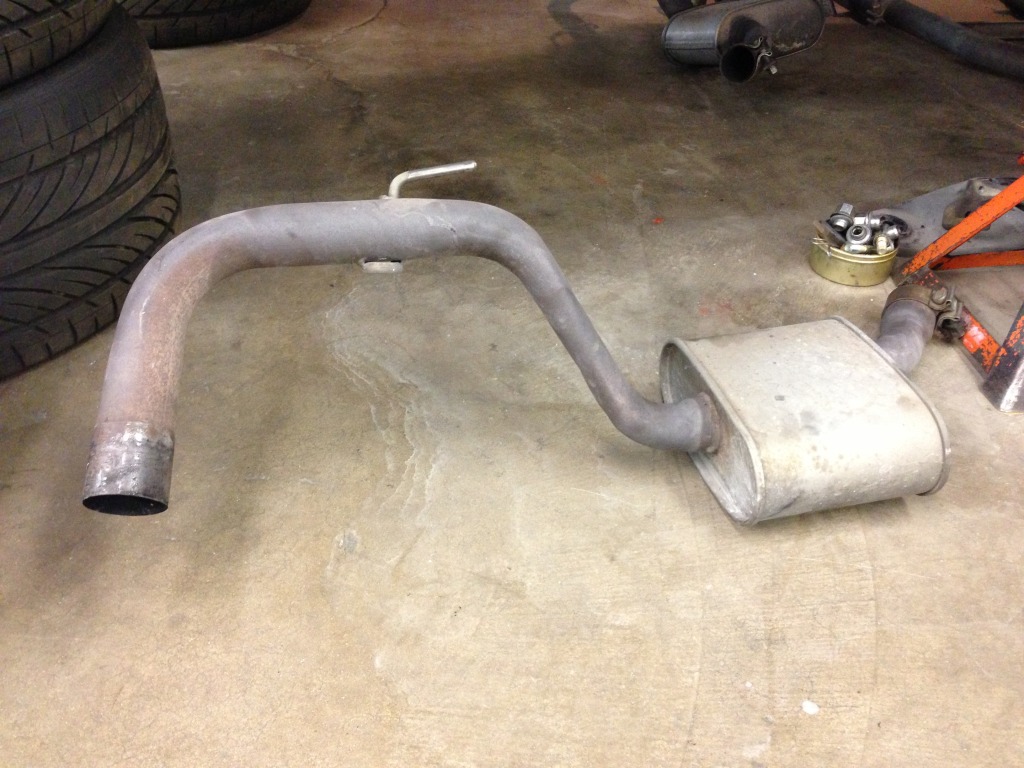

When I stopped by Falconworks to check up on the improvements that they're doing to the XKR (almost done) I got quite a surprise.
The photos below are FACTORY parts:
LOOK HOW SQUISHED THE FACTORY PIPES ARE! This is on both sides of the car!
I remember that someone makes a kit to go straight past the rear suspension. How do you guys like it?
I can't believe that I'm pushing this much power out of this 4.2 only to have it plugged up like this! AAAAAAH!
This is going to get fixed. I'm downright perturbed.

Mina was really nice and set me up with an updated hanger kit. I bought THIS to have installed on Monday:
Performance Exhaust Mina Gallery for Jaguar XKR

When I put in my Mina Exhaust I likewise was flabbergasted by the restriction in the factory exhaust. I have always been happy with my Mina and Nameless exhaust combo.
I just try to avoid gravel roads like the plague with that beautiful polish on them.

As an ex-Zoni I would be concerned about under the axle if you are lowered. Especially if you are driving the hills around Tucson. MarcB has the under axle setup and lowered and on our run on Monterey he scraped a number of times on the back roads. A custom shop should be able to get you full round pipes over the axle. Or...you could go with side pipes with an "X" crossover.

Yup, lowered and under the axle is not the best combination, watch out for road hazards as you will only have about 2 1/2" of clearance. I have had the under the axle sections replaced once already and I need to do it again soon. Per Dave's comments next time I am going to have over the axle pipes made.

If I recall correctly I believe Avos has mentioned that he has an X pipe and sport cats but an otherwise stock exhaust. His power seems to be just fine, even with the restriction.

Indeed, I have just the stock exhaust and sport cats (no x-pipe).
Wouldn't claim it to be optimal, but also not very restrictive. Pending of course how far you want to go in power, as obviously the higher you go the more effect a suitable exhaust can have. For me the test I once did with a x-pipe didn't show any significant power difference (to my surprise), so the sports cats with stock exhaust will do for me now. Maybe if I would test for 700 hp I will check it again.
