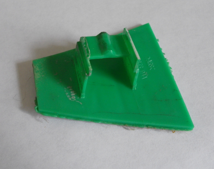

Difficult to be sure from the Ebay listing, but I'm not sure the one you need the most and the one that gets broken the most and the one that is theoretically available as a separate part - the top rear clip - is part of that kit. It has a triangular base and I can't see one like that in the pictures.
This is my broken one :
Attachment 91408
I don't see that one either, think I see the other that I need. I don't know which of these break most often.
