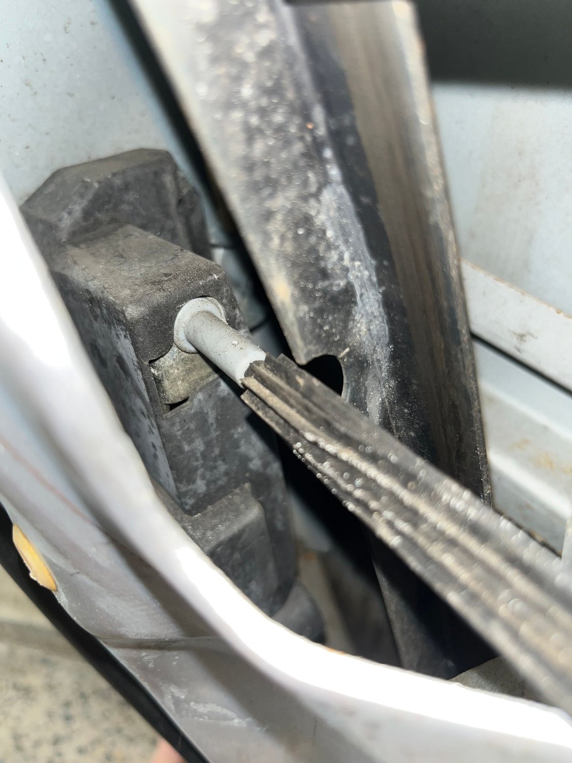

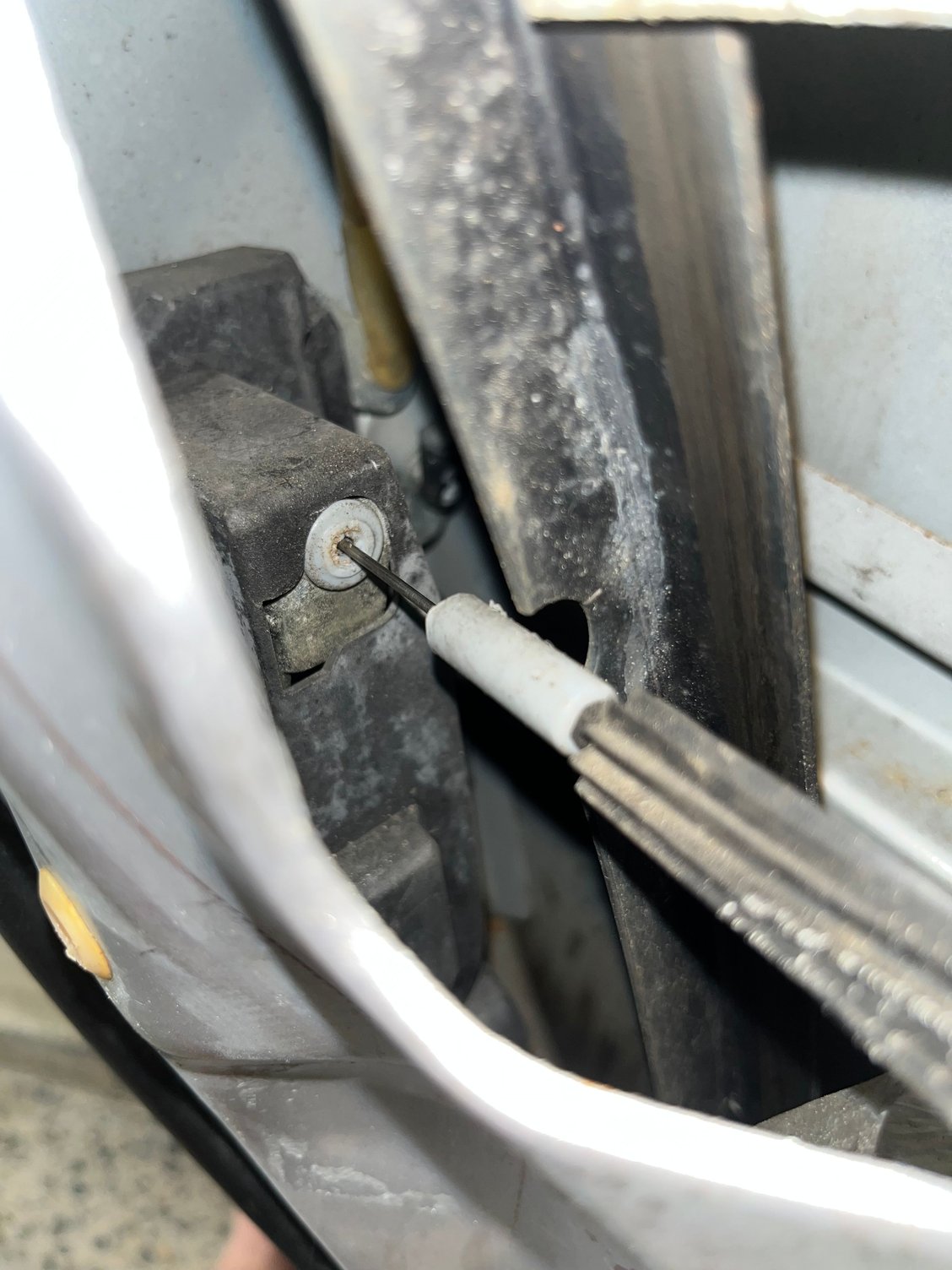

Found the issue. That grey plastic that pulls the lock broke.

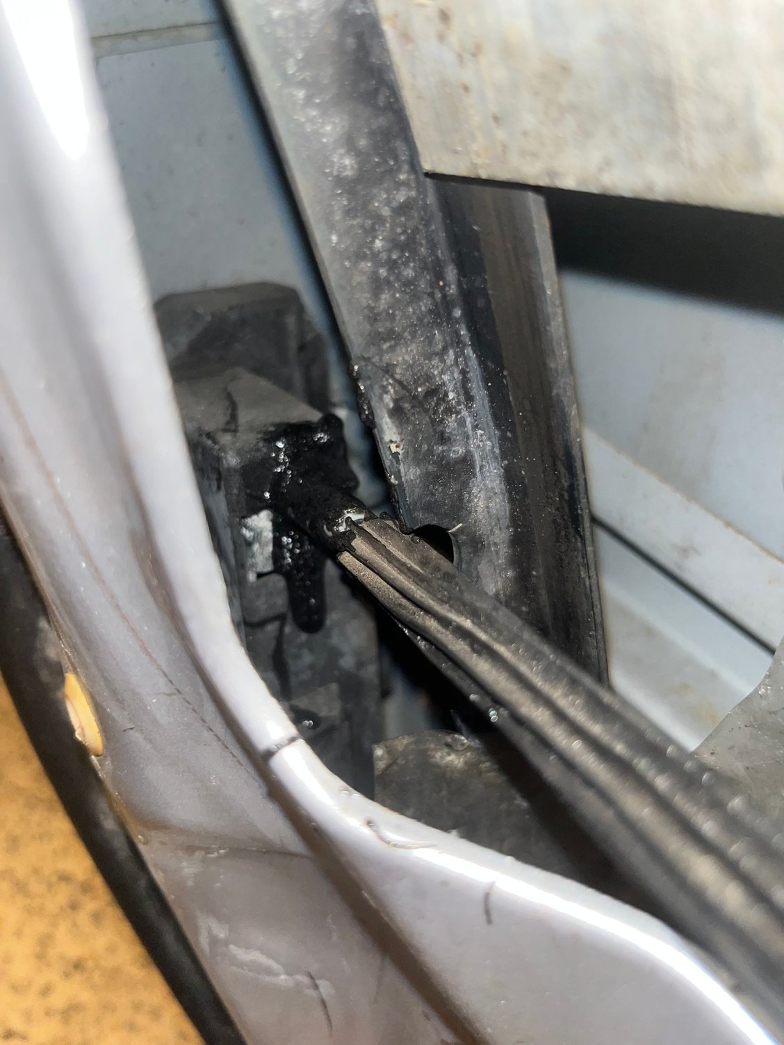

I fixed it with a stupid amount of epoxy. I let it cure for a few hours and came back to it. Works as good as new.
