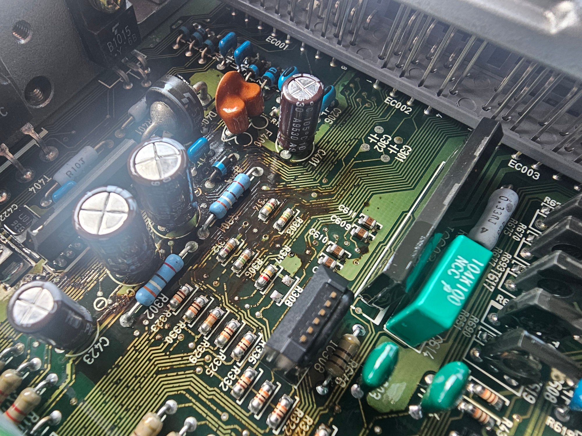

Hi if yours is a early unit 97, 98 unit numbers LJA1410AH, LJA1410AK, LJA1410CA it is most likely the capacitors on the board they fail and leak on the board potentially damaging the traces. It is a common issue if you open the ECU you can tell if they leaked, or look at the top of the capacitors if they are bulged up they are failing. Any of the ecu repair companies know of this issue and to be honest any good electronics repair place can change the capacitors. The below picture shows what they look like when they fail. You can see the bulge in the one very clearly and the discoloration on the board. This unit i fixed myself replaced all the capacitors and cleaned up the traders and it came back no problem.

Thanks Dave,
My unit is a 2001.
Will keep you all posted.
Thanks again!
