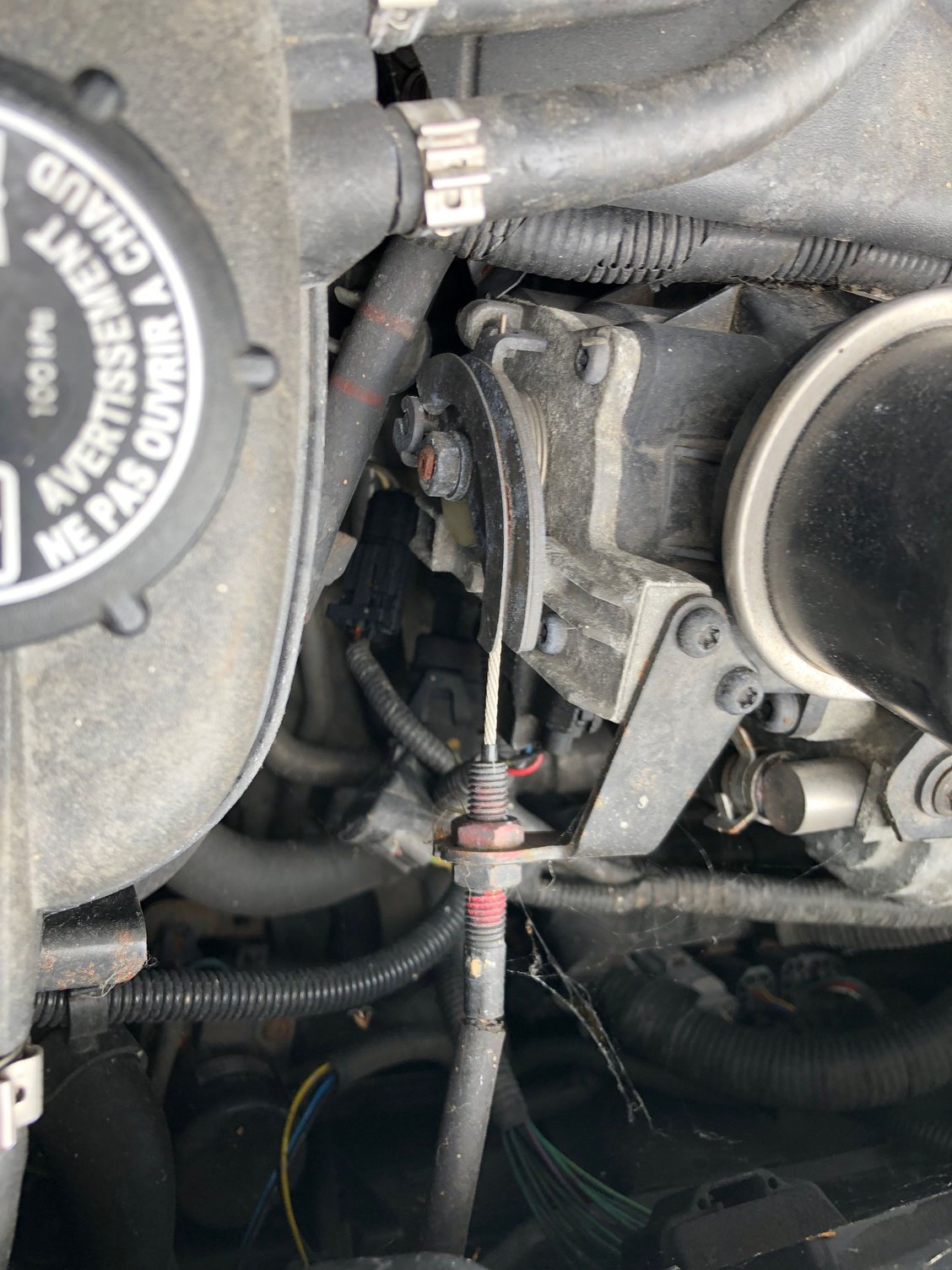

One thing I did come across when reading too was to ensure the throttle cable had not stretched over the years. I couldn’t make head nor tail of the description how to check, but if someone could advise from the attached picture alone I’d be really grateful! Thanks again all
