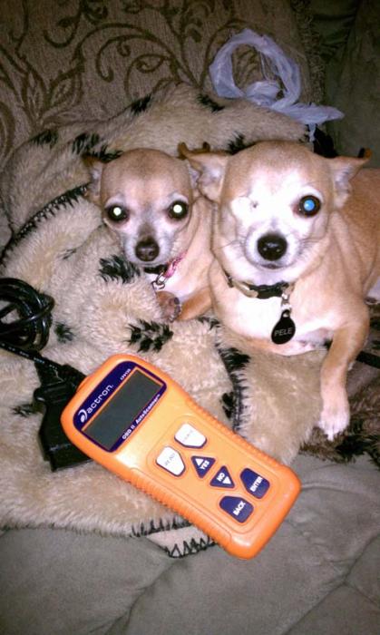

Hey Bass, if you need an OBDII tool I've got one I'll sell you cheap. I don't need it any more now that I have Torque installed on my non-Apple phone.
Seriously. Just PM me if you're interested. $40 including shipping. They are selling on eBay for anywhere from $45 to $89 plus shipping right now. It's an Actron CP9135. Here's a pic:
I put the dogs in the pictures to show the size of the device. The dogs are Great Danes so as you can see it is huge! Shipping alone will probably cost me $40. The dog on the right is a Pirate. He lost his eye in a sword fight with Johnny Depp. Normally he wears an eye patch but he's feeling casual tonight.

Personally I think an OBDII scanner is a required tool for anyone who is the least bit handy. There is so much info you can get from them, and you don't have to take the car to the dealer or the auto parts store. I'm not trying to talk you out of buying the one above, but if I was you I would buy one of those bluetooth tools I posted in the other thread and get that app for your iphone. It will give you much more info than the Actron tool above.
