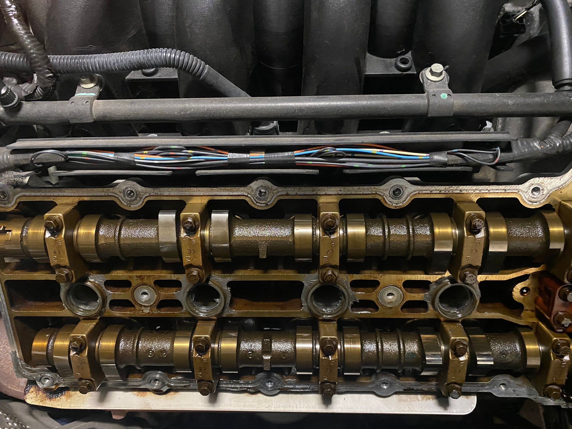

The cams are not aligned. They seem to be phased 90deg apart.

They look OK, or pretty close.
You need to put a breaker bar on the crankshaft bolt and rotate the crank clockwise until the two flats on the cams:
are uppermost and horizontal. Put a straight edge across them to confirm. Do this on both heads. All four flats should be horizontal at the same time.
You do have the old-style plastic tensioners, I'm afraid.

What is a "flat"? I see cam lobes and separation angles...

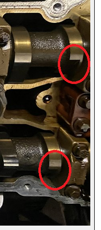

Take a look at this post from Dnjaa & expand the picture
https://www.jaguarforums.com/forum/x...74/#post968233

Ok gotcha...
