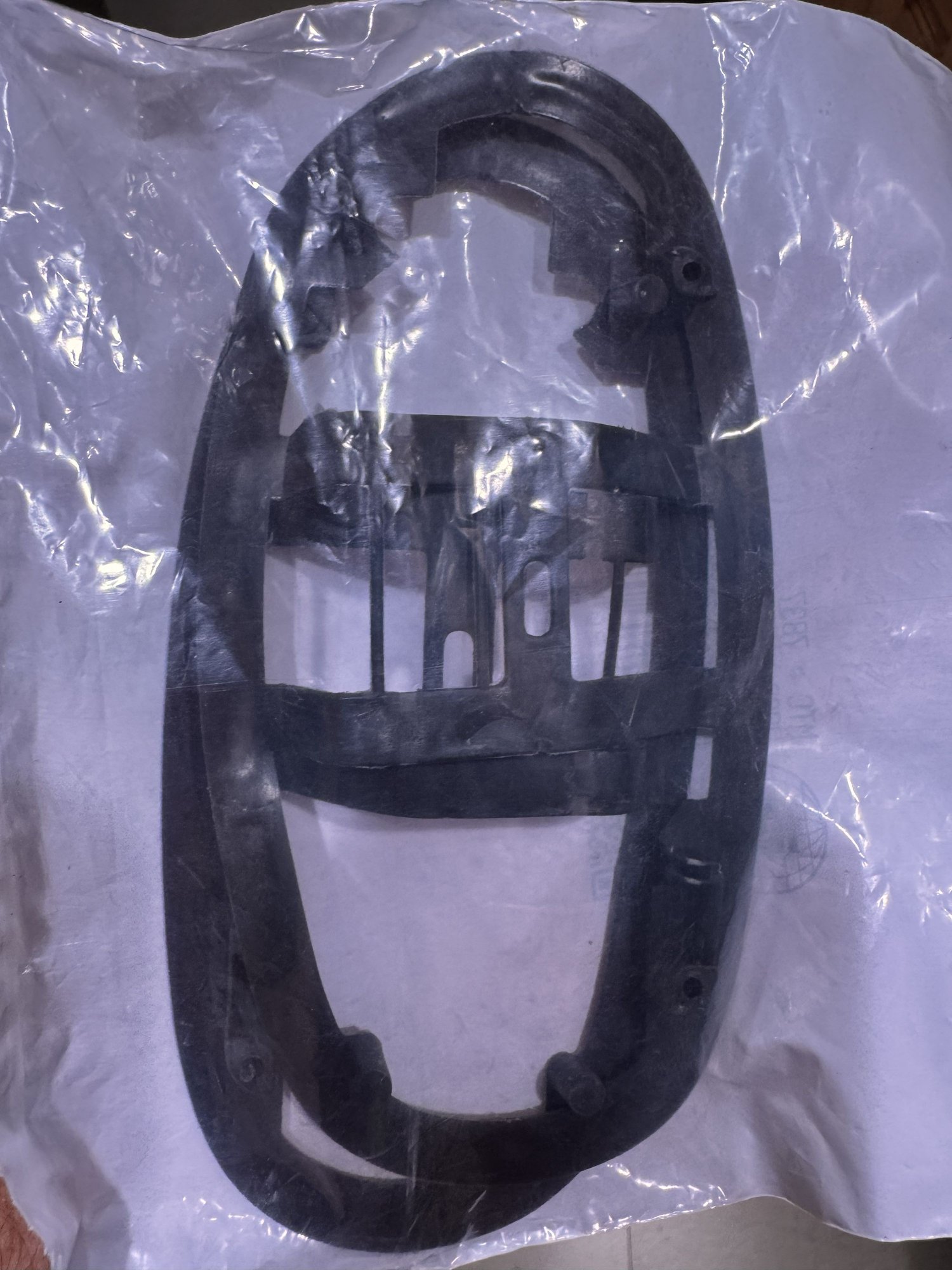

OEM look like these, but are almost unobtainium:
Mine are also crumbling where the light gets to them. Given that X8R wants the equivalent of $54 to ship across the English channel, my fix will be to clean up the gap and dress with a bead of black RTV.
I suspect that the RTV will be the most useful part of the kit...

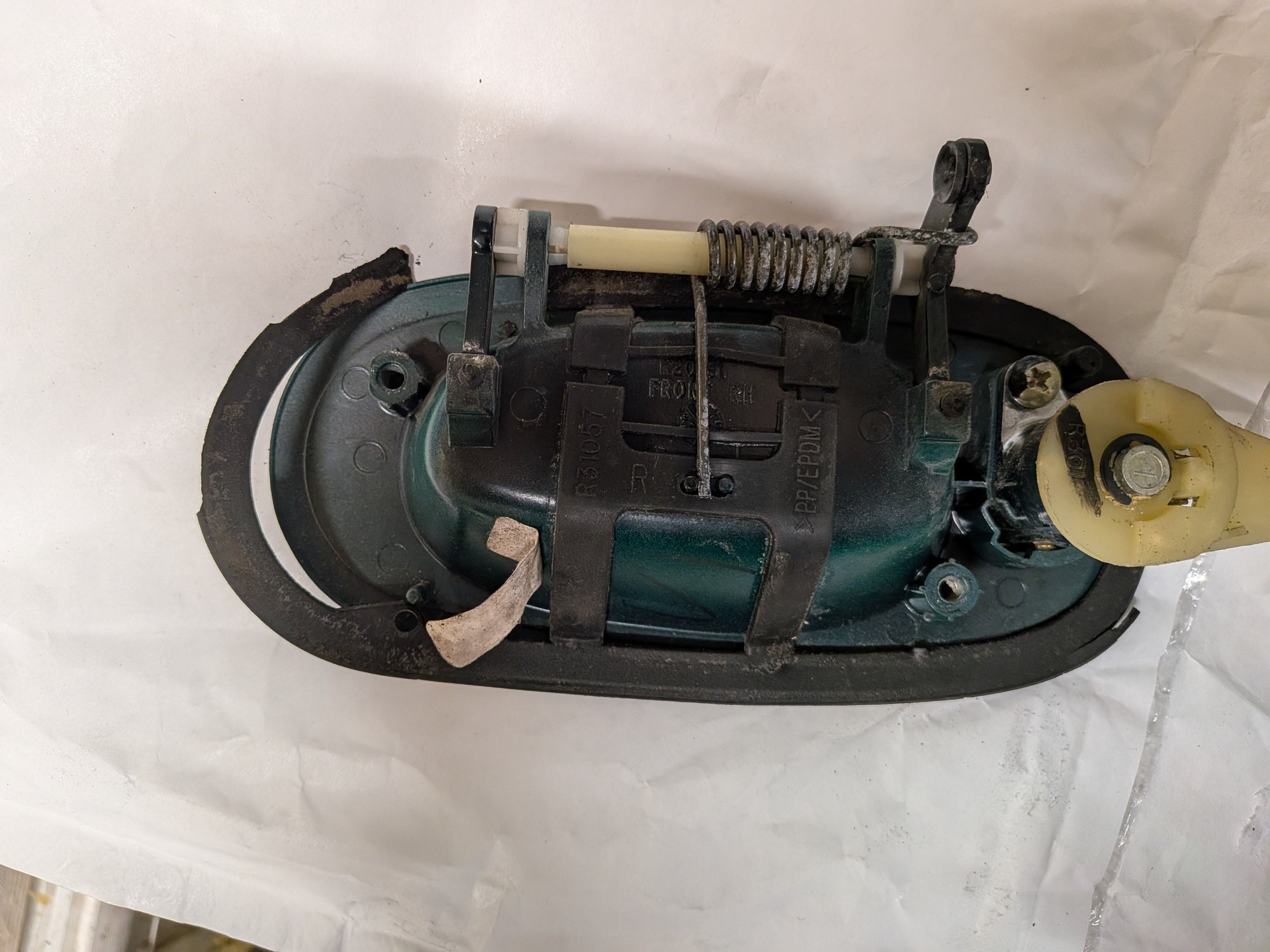

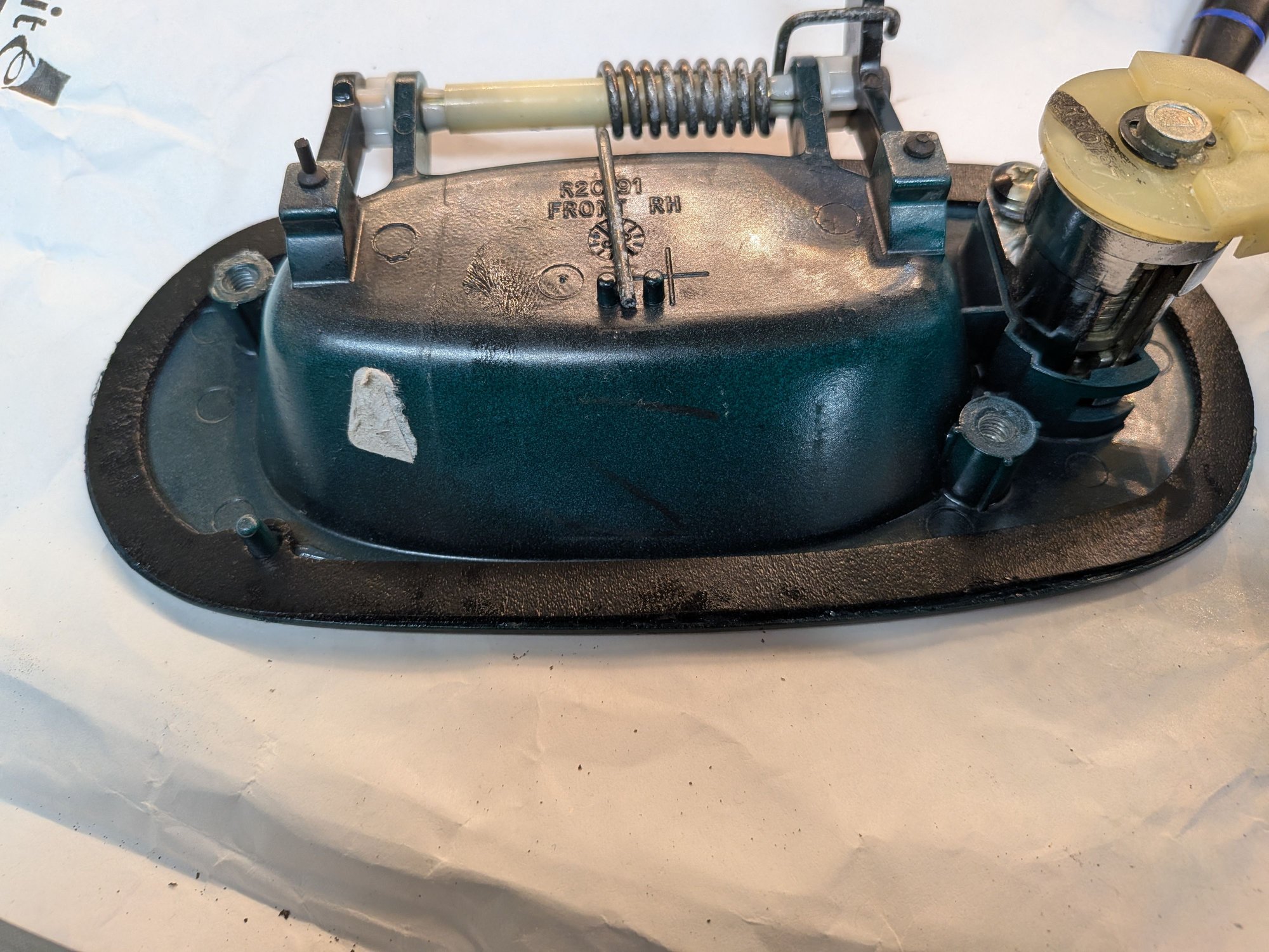

I put in the new gaskets yesterday. It's a bit of a buggar to get to the 7mm bolts if you have hands larger than those of a child, and the drivers side door handle is tricky to get in and out because of the door lock but I got there in the end.
First impression is that the new gaskets are significantly less substantial than the originals and it's hard to imagine that they'll last as long. Nevertheless, I tested them with a strong jet of water 24 hours after I've fitted them and there were no leaks or dampness around the inside of the handle. Things I learned:
  • Wind the windows right up and then disconnect the battery so they don't start dropping as soon as you mess around with the handle (mine is a convertible so the windows automatically drop when you open the door - not sure if it's the same on the coupe)
  • Pop a rag or something similar inside the door to catch the small 7mm bolts when, inevitably, you drop them
  • I attached the gaskets to the handle with the supplied sealant and left it to harden - the flimsiness of the gaskets means that it's otherwise hard to keep them in place when you wrestle the handles back in
  • I found it much easier to get the drivers side handle back in by disconnecting the rod between the handle and the door mechanism at the bottom end. No need to do that on the passenger side - it pops back in easily
  • It's easy to rotate the rod out of position and end up with badly adjusted handles - I had to adjust back which would have been a pain if I hadn't noticed before I put the door card back in. Again, it was easier to adjust at the bottom than the top
Despite my concerns about the longevity of the new gaskets, I do think they look better than the old one - seems a bit of a cleaner finish.
Original gasket, fresh out of the car:
New gasket positioned and sealed in place.
Drivers side handle installed. Looks nice and clean without the original plastic gasket, I think.
