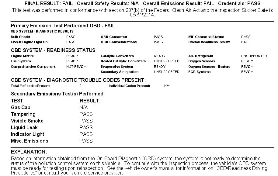

Thanks for the website. Here is a screen shot of the failure.

Looks like your evap monitor is "ready so disregard my previous direction in my previous post. Let;s see what the other members have to offer here. Thanks
