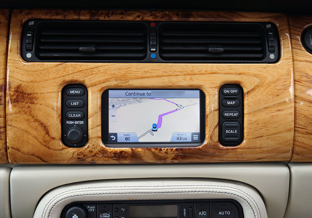

Default So I went one bigger (2799) because I could.
Hi guys I'm just back from a stint away and noticed this wonderful thread. I did the same in October but with the bigger Garmin unit, the 2799. My aging eyes forced that decision.
The unit is very flat and sits really nicely over the top of the old GPS hole. The Garmin is just wonderful. I spliced the power cable into the cigarette charger cable and the unit automatic switches on and off when the car is started or switched off. Brilliant.
The small unit above the Garmin is a French Coyote traffic advisory system. it is magnetically held in place just above the Garmin and comes off within seconds. This traffic advisory unit is unofficially used to spot speeding cameras and any mobile units, Oh and any possible traffic problems. It makes each user a spotter. Quite handy really.
I've added a photo to show what the bigger Garmin looks like just in case someone wants to try.
