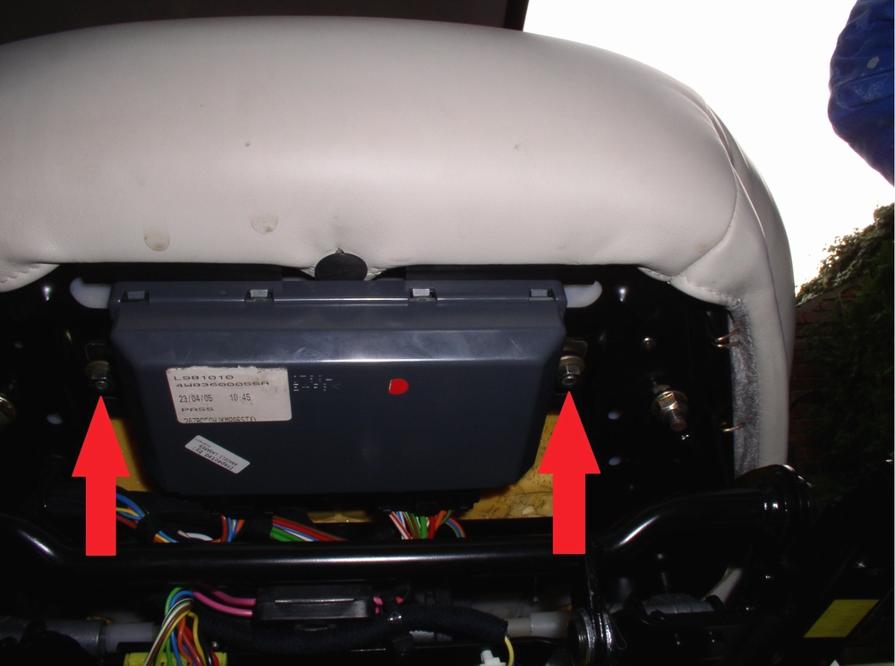

The most common problem for the seat to stop operating is the seat module. If you look under the front of the seat you should see 2 bolt heads. I think from the last time I did it they are 10MM. Remove the 2 bolts and the seat module can be removed. Do the same thing on the passenger seat and then plug the module from the passenger seat into the driver seat plugs. You should now be able to move the seat.
If that works then your seat module needs to be repaired. Let me know it worked and I will dig up the phone number for a great fellow in California that repairs them. He has done 100's for the forum members.

Here's the Seat Module fixings on a 2005. The 2000 is similar:
There's not a lot of room to work beneath the seat so it helps to know what you're trying to find.
