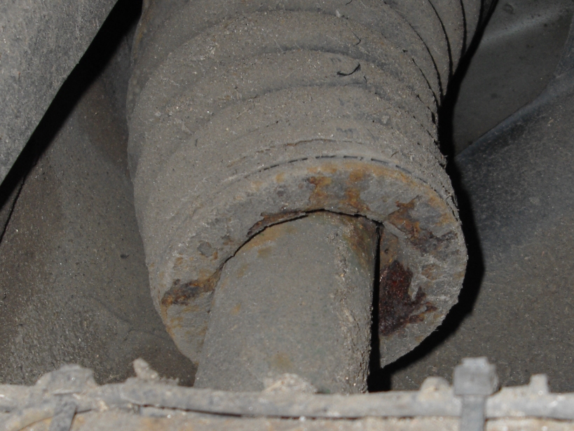

My car failed the MOT (Annual Safety Test) today - excessive wear on both front shock absorber (damper) lower bushes.
Two questions - is it possible to replace the lower bushes without removing the complete front strut assembly, and - perhaps more importantly - is there a problem with this spring and/or spring mounting ?
The photo shows the bottom of the spring and it's obviously well off-centre. The steering is on full lock (to be able to point the camera) but it doesn't look right to me.
(Sorry it's a bit mucky in there, but we're just coming out of winter, and I haven't had time or inclination to get the wheels off for a proper clean up under the wheelarch. !!)
Old Mar 12, 2015 | 10:38 AM
ccfulton's Avatar
Posts: 2,953
Likes: 1,120
From: Phoenix, AZ USA
The spring seat should be centered around the shock, only way what you are seeing can happen is the perch or the shock body has rusted so much that the support has disappeared on one side.
That qualifies as dangerous.
Fortunately non-CATS shocks are not too expensive and new spring perches are available as well.

Thanks Charlie and RJ. I think the top mounts are OK and agree that it's most likely that the perch / pan has corroded badly. I assume it wasn't noted by the MOT inspector because it probably looks OK with the wheels centered. Shocks may, or may not, need replacing, but it's pretty obvious that I need to get the complete suspension strut out to get it sorted !

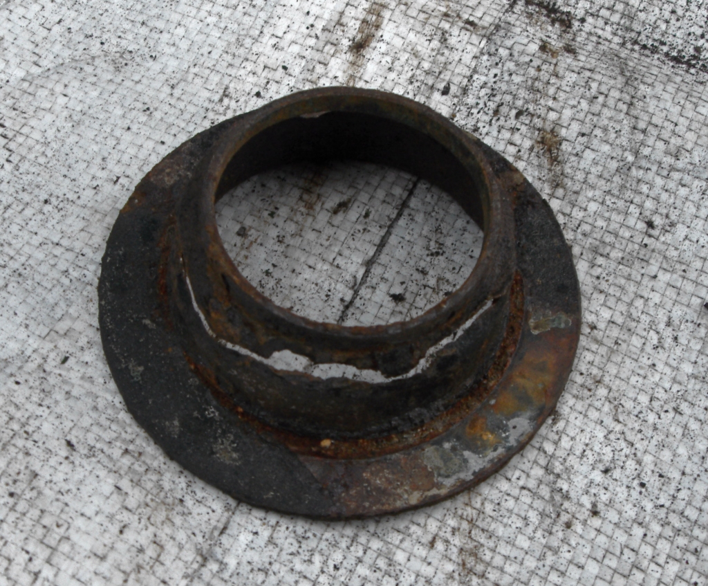

Took the front suspension to bits today - found the problem which is the "pan" which supports the lower end of the spring :
As you can see, it has nearly rusted completely away, so I count myself lucky that I found it before it totally collapsed. It's a bit scary that the front suspension relies on a fairly insubstantial mild steel "pan" and a very small lip on the side of the shock absorber (damper).
Will do an "update" once I start getting new parts, and the reassembly starts, but for those in wet climates with roads which are salted in winter, might be worth having a quick check to make sure you haven't got the same problem !!

Glad you found it before something catastrophic happened.
Old Mar 15, 2015 | 04:43 PM
Posts: 25,864
Likes: 4,708
Damn - I echo Charlie's comment - better to have found now before a catastrophe!!!

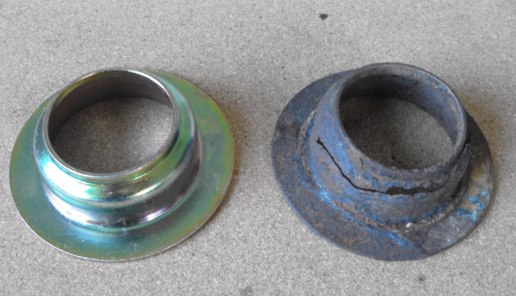

All new parts now arrived, so I am starting to put my front suspension back together again.

Default Spot the difference
RD - I had a pair of spring compressors bought many years ago, but when I saw the XK8 springs, I realised they would be about as much use as a chocolate tea-pot. Got a pair from Screwfix - very strong and I felt reasonably confident that they would do the job. A bit fiddly to use but got the job done today. Tomorrow I hope to get the strut back on the car, put the hub / top wishbone back, and (with luck) get it back on all four wheels !!
