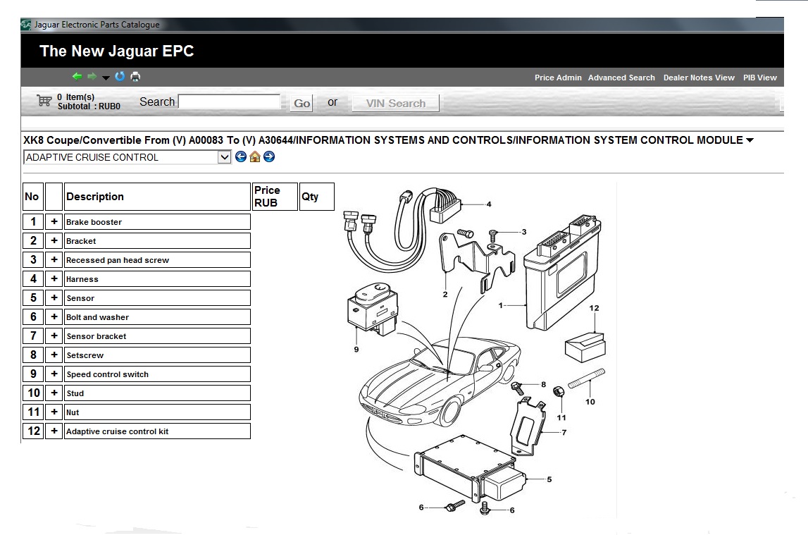

Presumably it is the Adaptive Cruise Control Sensor (item 5) which is giving problems?
Unfortunately this is a programmable unit so attention from a Jaguar Dealer or Independent with similar level diagnostics in unavoidable.
