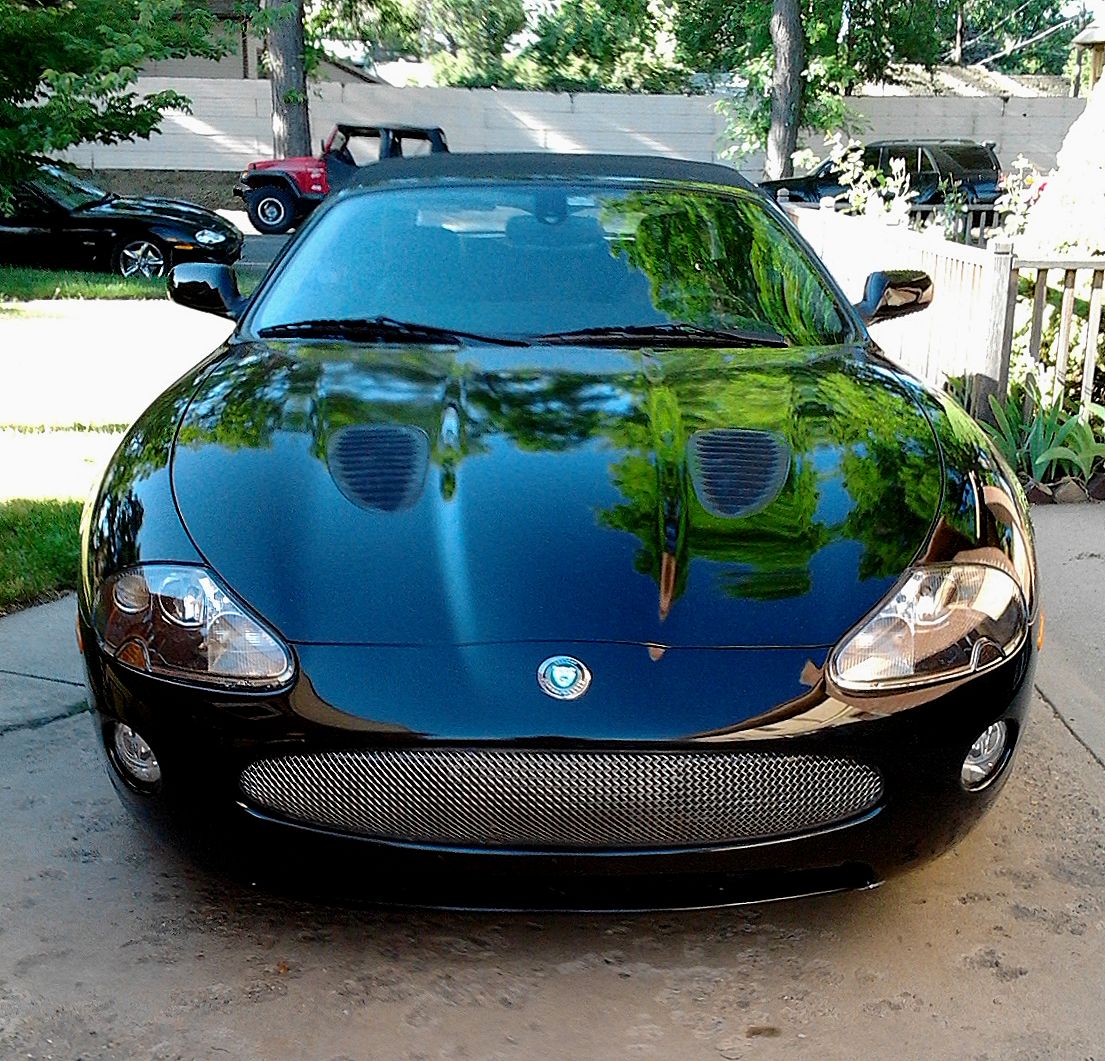

Default Help in sorting out a few issues with my "new" XKR
Greetings,
I am going to dig in and so searches on these things, but wanted to put them out to this most awesome group as well.
2005 XKR Convert, 42K miles, just delivered from the east coast. First drive found the following:
1. That power steering column... it telescopes in and out, but not up and down. I hear a click when attempting, but no motor sound. My XK8 has the opposite problem, will go up and down but not telescope in or out, so maybe there are parts available in-house.
2. Traction control will not disengage.The switch does not light up or take it out. The first drive I put it through some spirited corners under throttle and could not get the tail to kick out as the computer took over.
3. Driver's door panel is lose top left corner.
4. A pillar fabric is lose and bubbly.
5. I thought the NAV system would display the clock, oil pressure, and temperature gauges when not in NAV, but all I get is the clock. I miss my analog gauges on my XK8!
6. The CD player seems to skip pretty easily over bumps. Any suggestions on a good MP3 interface? I have used an RF modulator on another car with mixed results.
7. I swear the legroom is two or more inches less than the XK8, the seats are thicker on the R. is there any way to regain this? I am 6'3'.
Thank you!
John

Btw, SUWEET car!! Exactly the one I was looking for!! Only found a 2002 local enough so I added the arden kit.
Gotta tell you, I originally had the same grille on mine, then changed to a black inset flat grille!! Talk about aggressive!! Yours would look killer with same grille!!
