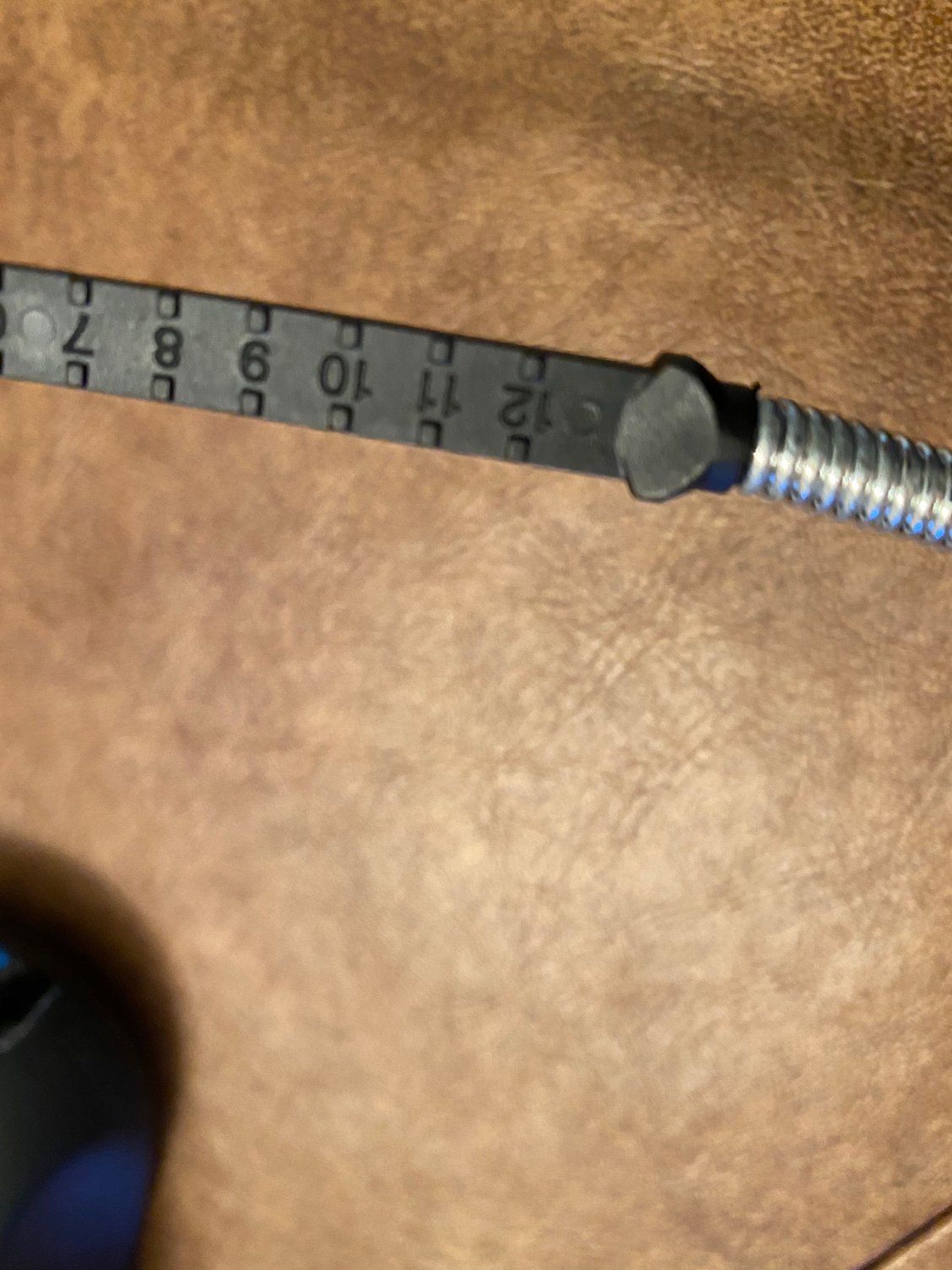

Hi All,
Is there a good write up walking through how to check the fluid step by step on the Mercedes box? Do I just pull off the tube that says "MB workshop only" and put the dip stick in?

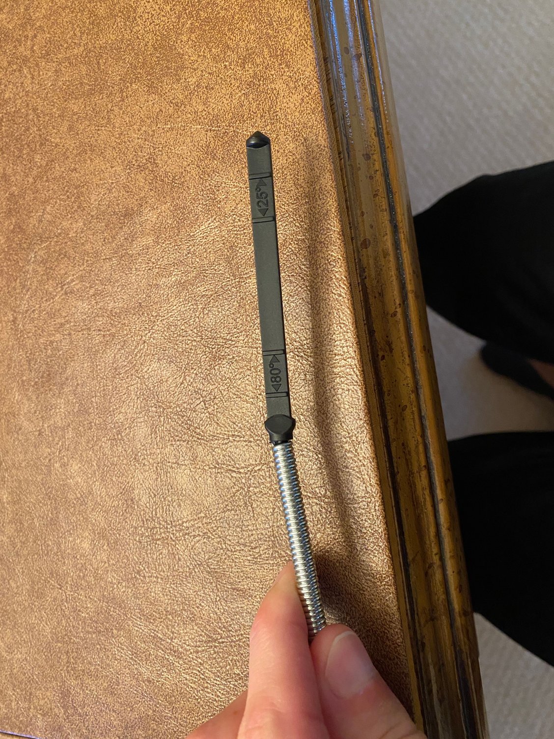

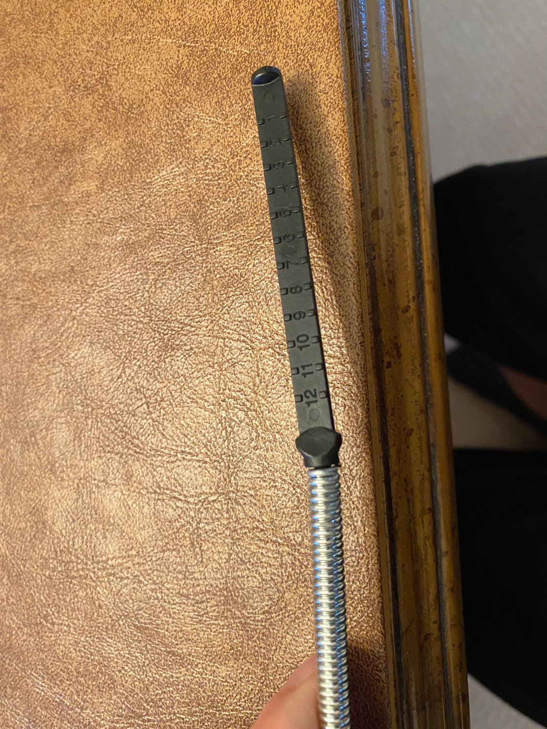

I purchased the check dipstick years ago. Just opened it this morning..

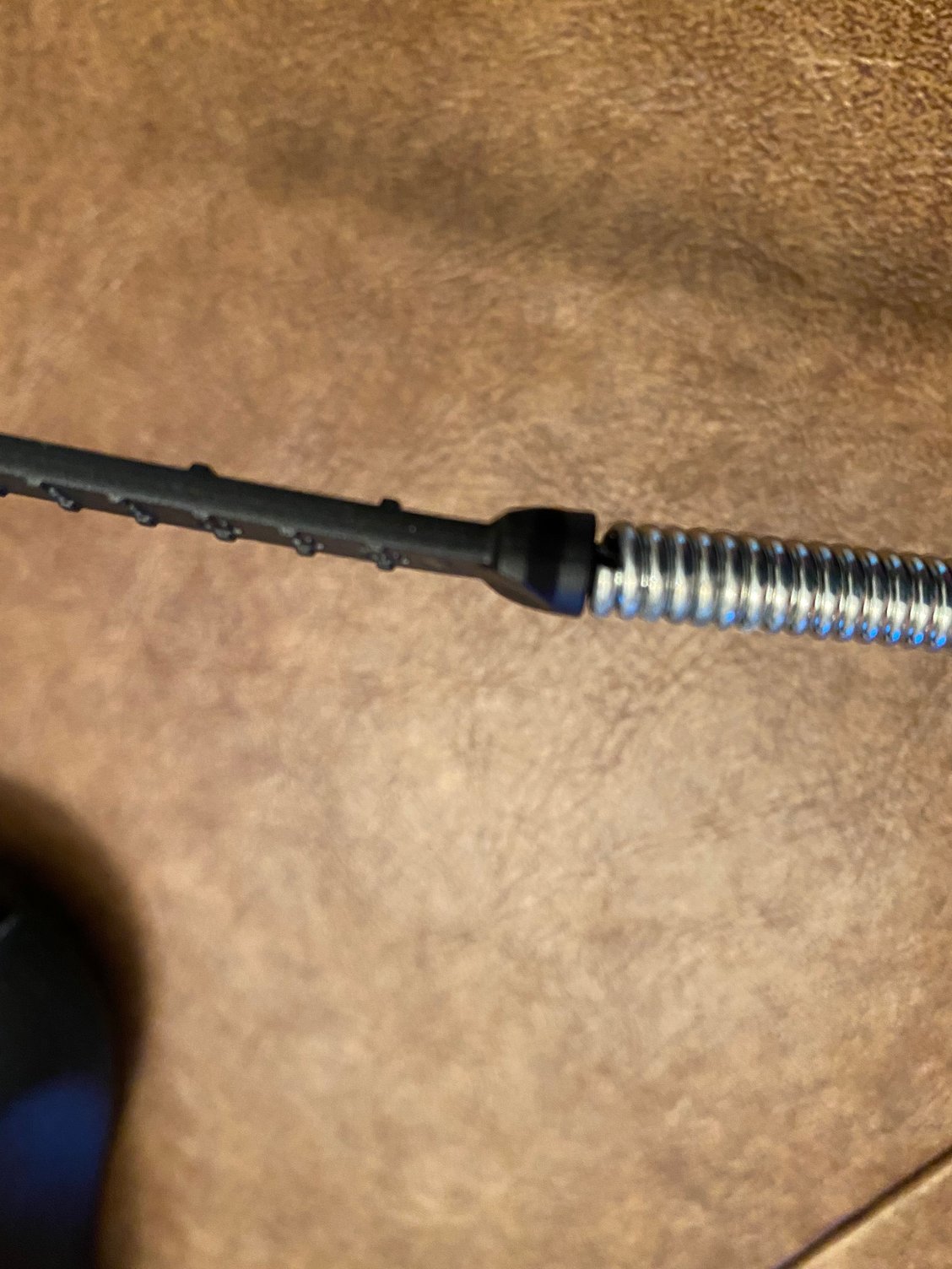

Did I buy the correct one? I see it has the "ears" where it should stop going further into the transmission. It looks a little questionable like the measurement part is not very robustly attached to the rest of the dipstick. Is everyone else's similar?
Thanks!!

Yes you pull that cap off. Yes it looks that janky on all the ones I've bought too lol.
I've used the infrared thermometer as well.

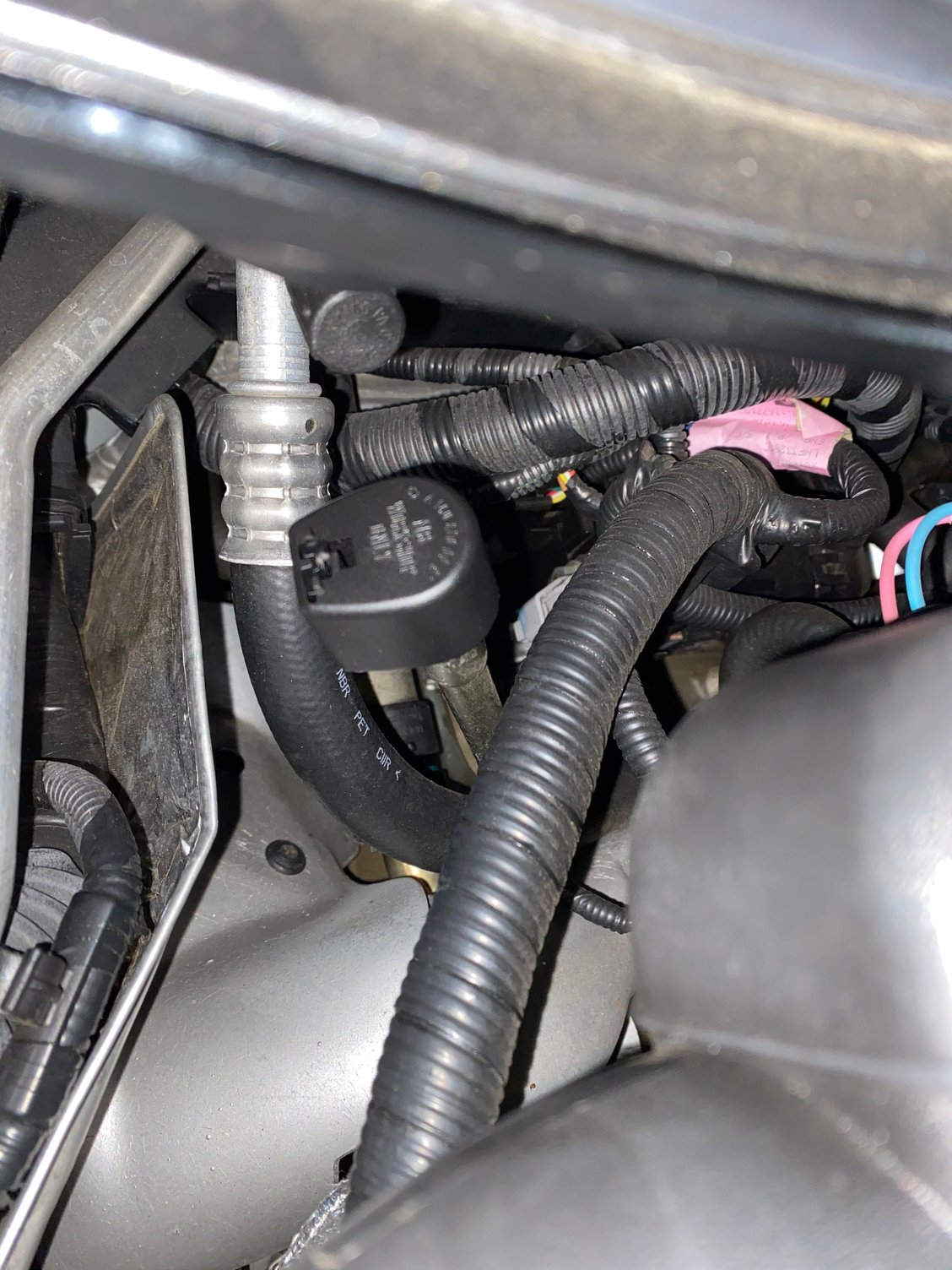

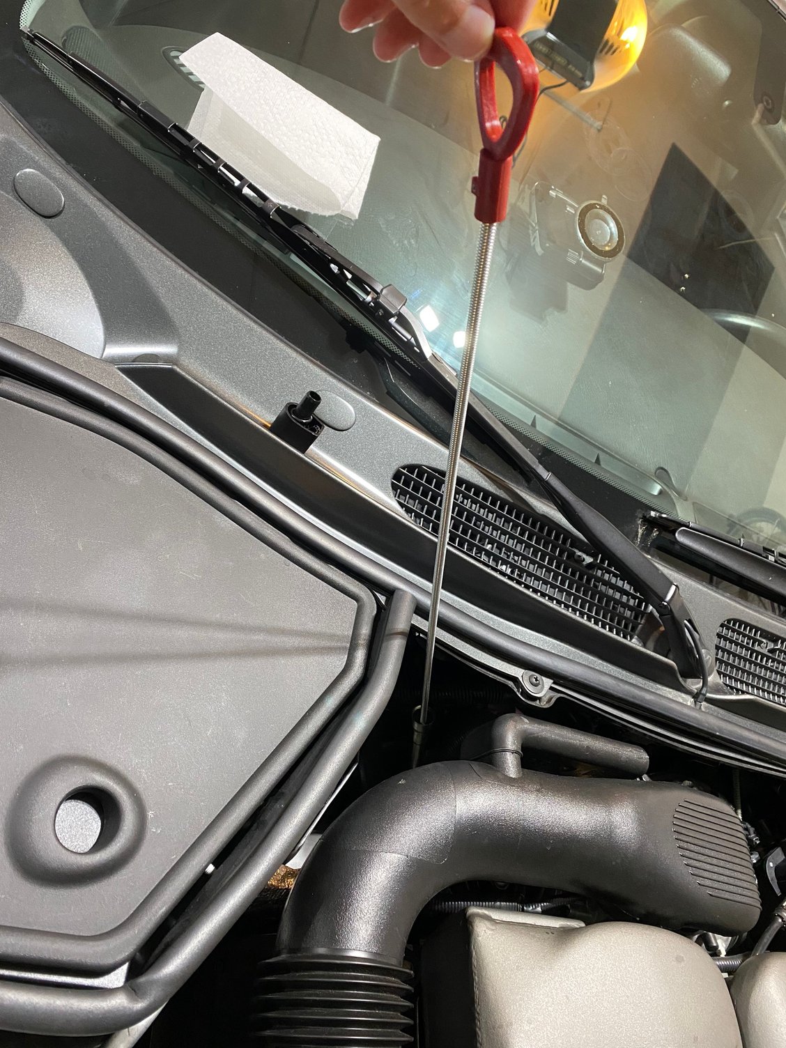

I just had my transmission serviced this week and wanted to check the level. Here is what it looks like.
Just pull that cap off. Measuring the level is a lot easier than you think when reading about it and it's a lot easier to change the fluid than you'd think as well.
There is no reason why it is "sealed for life".
Old Sep 11, 2020 | 11:12 AM
xalty's Avatar
Joined: Dec 2019
Posts: 3,695
Likes: 1,222
l
Just pop it out turn the car on and you’re ready to measure
Run it for 5 minutes, then shut off to check for "cold" level? Doesn't it have to be out of park to start circulating the trans fluid?
Then drive for 20 minutes or so, then check at the hot level?
Thanks!
Car on in P at all times when checking.
If it moves around fine now just drive and check at the hot mark.

The dipstick I use has just the 20 and 80 degree C marks, but appears to be constructed similar to yours. I’ve never had any issues with the tool coming apart.
it does take some trial and error to be sure the dipstick is fully inserted (insert off color joke here). But after a few tries it will become obvious when the ears have bottomed out.

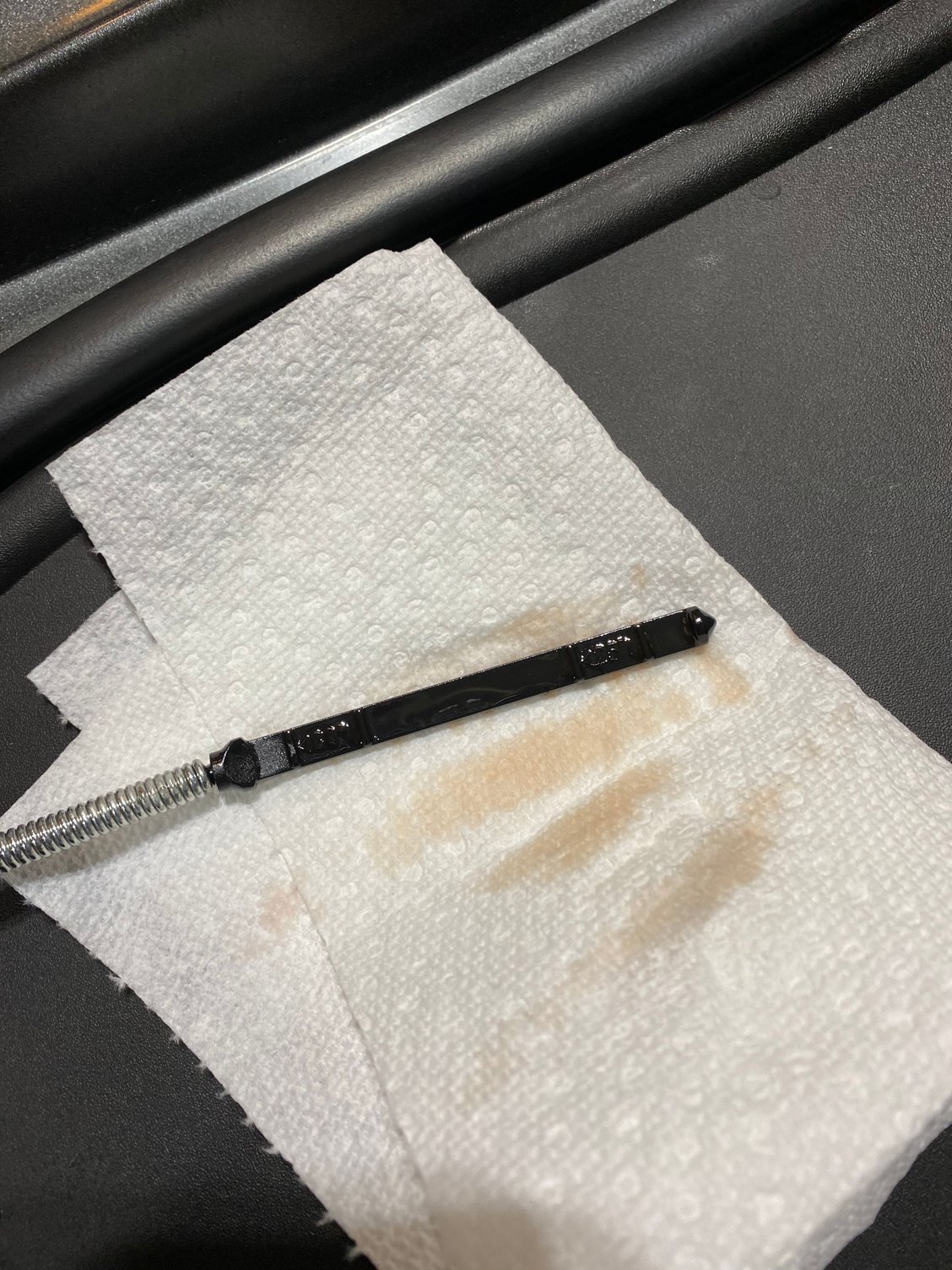

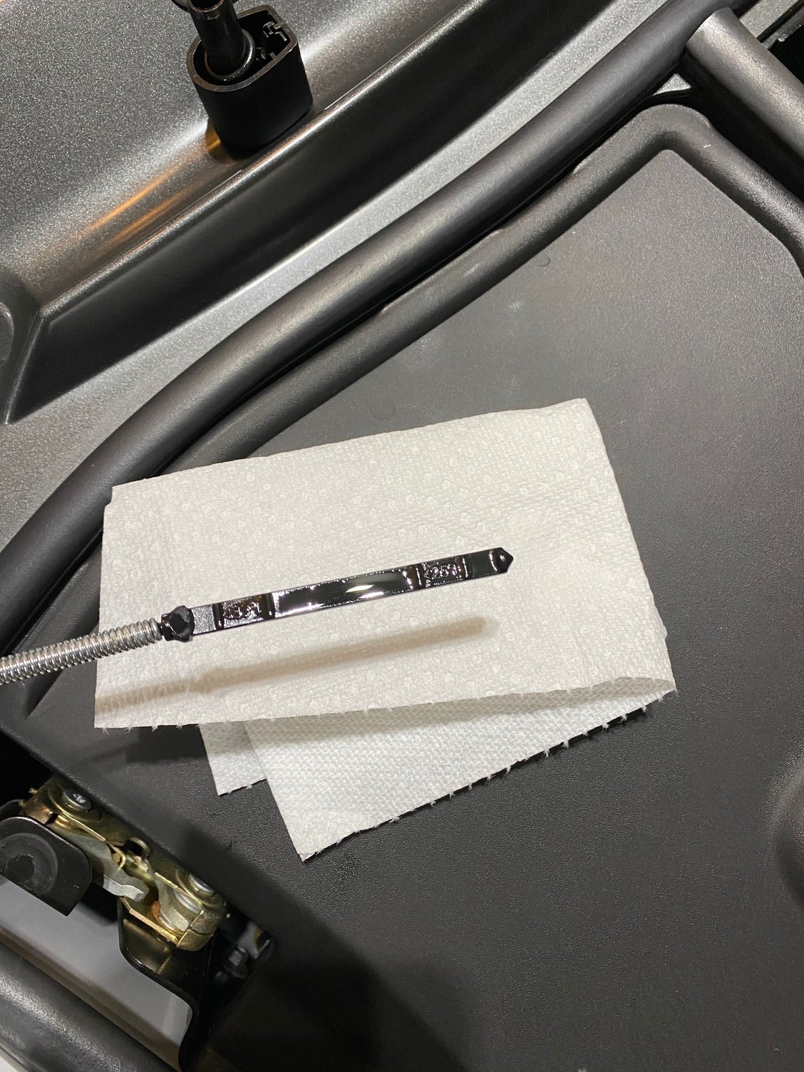

Here is what I found...
After running the car for about 5 minutes. The transmission must have been warmer than 25C..
I then went for a ride for about 20-25 minutes. I then plugged in my ODB2 reader which was showing 80-82C during my entire trip.
Once I went to put it in park the temperature raised to 95C.
1st reading
Second reading
My friend (a master Mercedes tech) said to get the most accurate reading you should check the temp in reverse or drive. The temperature sensor is in series with the range selector if our cars are set up the same. I heard of this advice after taking my above measurements. But I believe my mechanic filled it properly that worked on the car.
