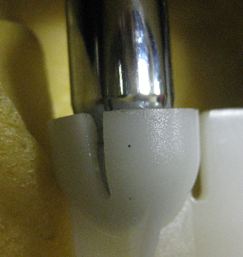

Just pull up and they release from the actuating mechanism. It is a ball and socket fit.
