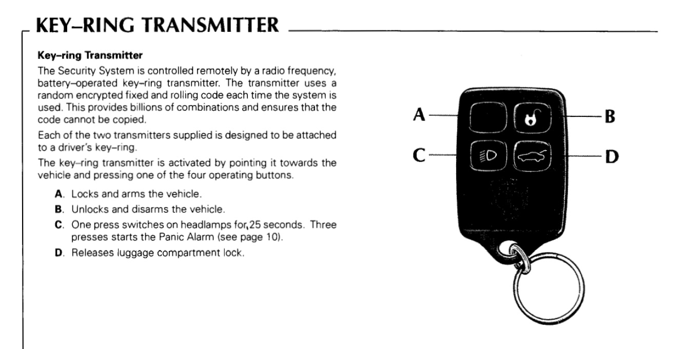

I purchased a 1998 XK8 in August of 2012. It only had one key & fob. When I used the fob to lock car, it sets alarm, but the doors aren't actually locked. Are they supposed to? I have purchased another fob on line and programmed it without any problem, it also sets alarm, but doesn't lock doors.

The doors should lock with the fob. Do they lock with the key and is it a black headed Master key or a green headed Valet key?
Here's how the fob should work:
The full details on locking/unlocking with key or fob are in the Security System Handbook for your Model Year. If you don't have this, you can download it (and the rest of the Handbooks) in PDF format from this link:
https://www.jaguarforums.com/forum/x...-2003-a-67827/

Both fobs are the same as pictured in your post. I have programmed both since the purchase of 2nd fob. They both beep & headlights flash when lock buttons pressed, but doors don't lock. I was thinking since it's a convertable, this was intentional, but apparently not. Is it likely that both fobs are defective?
