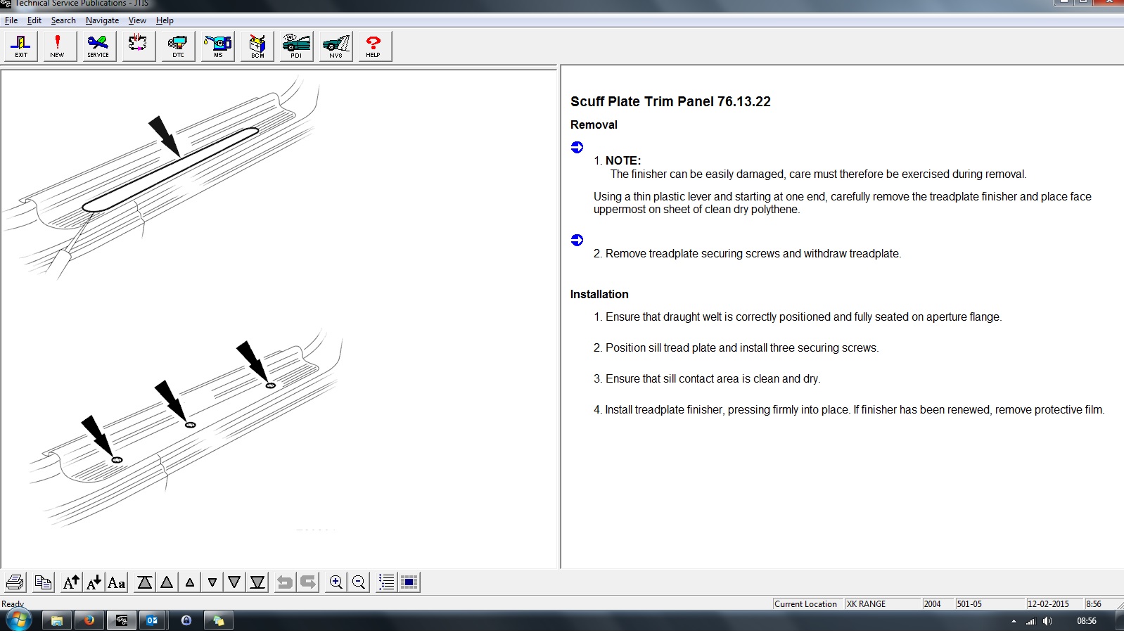

The Tread Plate?
If so - YES. The insert is glued in place and covers the three fixing screws.
It's very easy to damage the insert. I used a wooden spatula the lift the end on mine and then cut through the glue using a length of nylon fishing line in a sawing motion.
