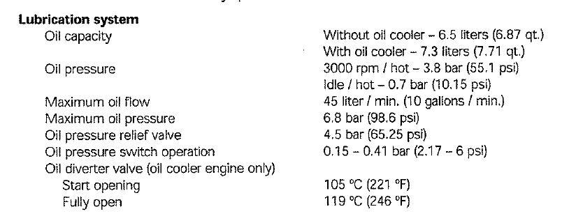

From: Horten, Norway
Hi.
Here you have the numbers for the lubrication system.
