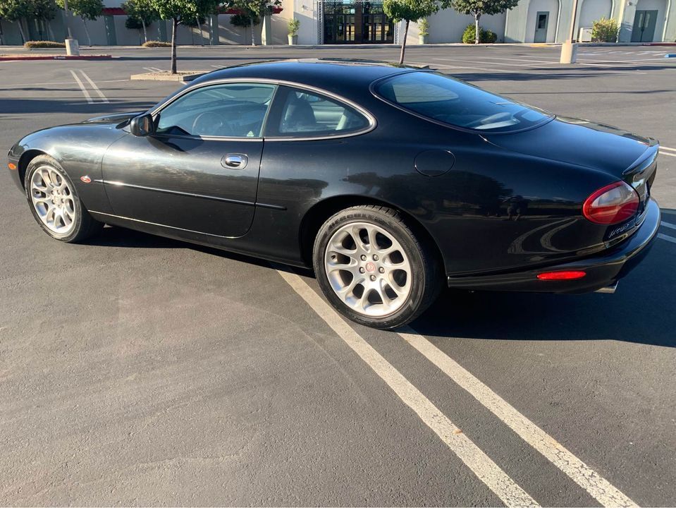

I would jump on that in a heartbeat - big plus with the Double 5 Rims! The XKR has the Mercedes transmission an Nakisil is no longer an issue to worry about. Not the best images (could be photo angle but looks like front end is sitting a bit low) but I would check the upper shock mounts for signs of deterioration - yeah low mileage but a 23 year old car with only 73K on the clock - I would venture to guess sure no one has even looked at suspension components in its lifetime. Not a show stopper and an easy DIY.

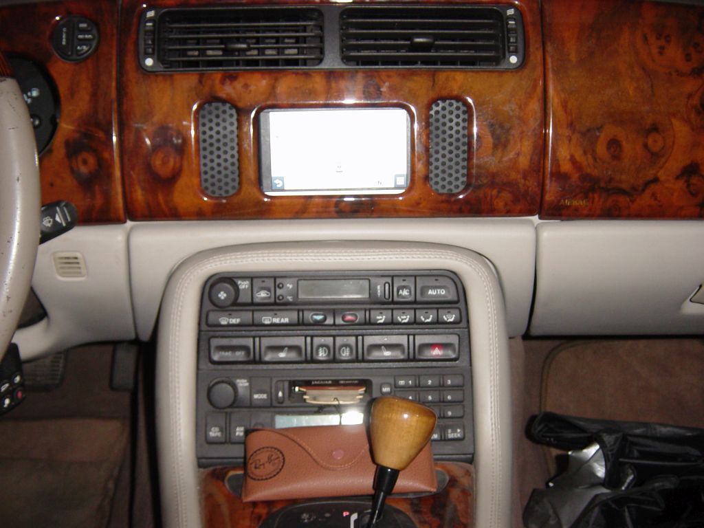

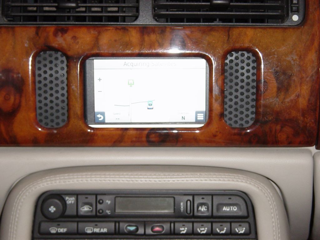

The NAV is mostly 'useless' but I removed the display panel in one of my 2000 XKRs that had that and replaced it with a GARMIN 2597 LMT and a Garmin BC 30 backup camera.
Hot glued some brackets on the veneer panel from behind and it works better than the factory setup.

Originally Posted by dfbender
Photo of your set up?
I got the same thing that I saw in this post from long ago.
https://www.jaguarforums.com/forum/x...satnav-111651/
The Garmin 2597LMT can be updated with software before installing in the fascia.
I added the BACKUP CAMERA option. (BC 30 kit)
Mine is installed slightly off to the right because there is a microphone hole in the lower left corner that I wanted to keep exposed.
The 'perf-metal' I found and used on the sides is so I can hear the speaker on the back of the GPS unit.
The camera flash reflection kinda 'washed-out' the screen but the actual graphics are great.
