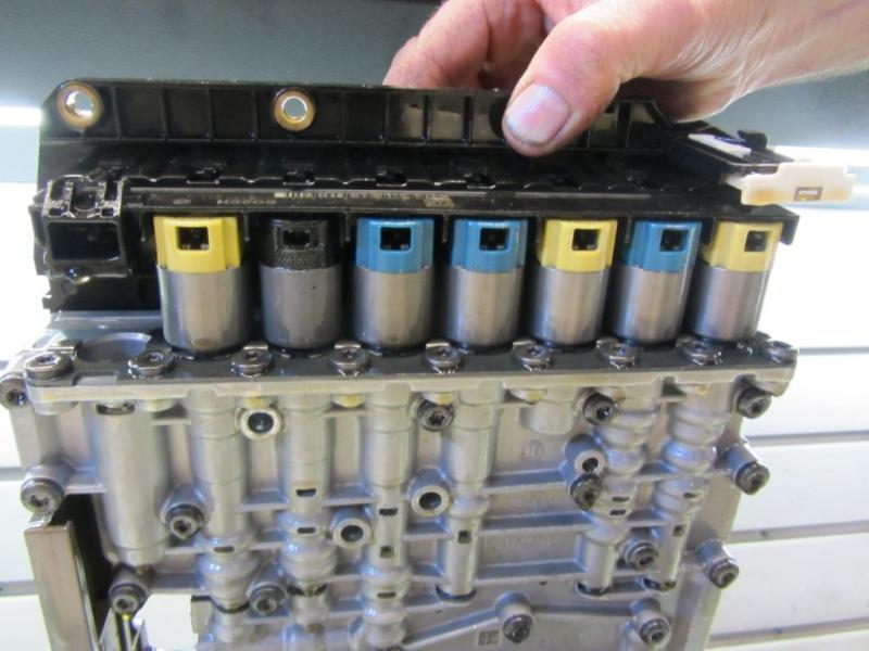

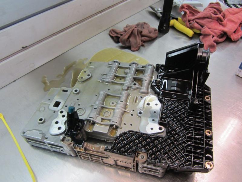

Since I now have them, here are my $850 (sigh) shots of the inside of the newer transmission.
Attached Thumbnails Merc Blue Top Trans Mod:  Not for 2004 ZF-img_1851.jpg   Merc Blue Top Trans Mod:  Not for 2004 ZF-img_1852.jpg   Merc Blue Top Trans Mod:  Not for 2004 ZF-img_1853.jpg   Merc Blue Top Trans Mod:  Not for 2004 ZF-img_1854.jpg
