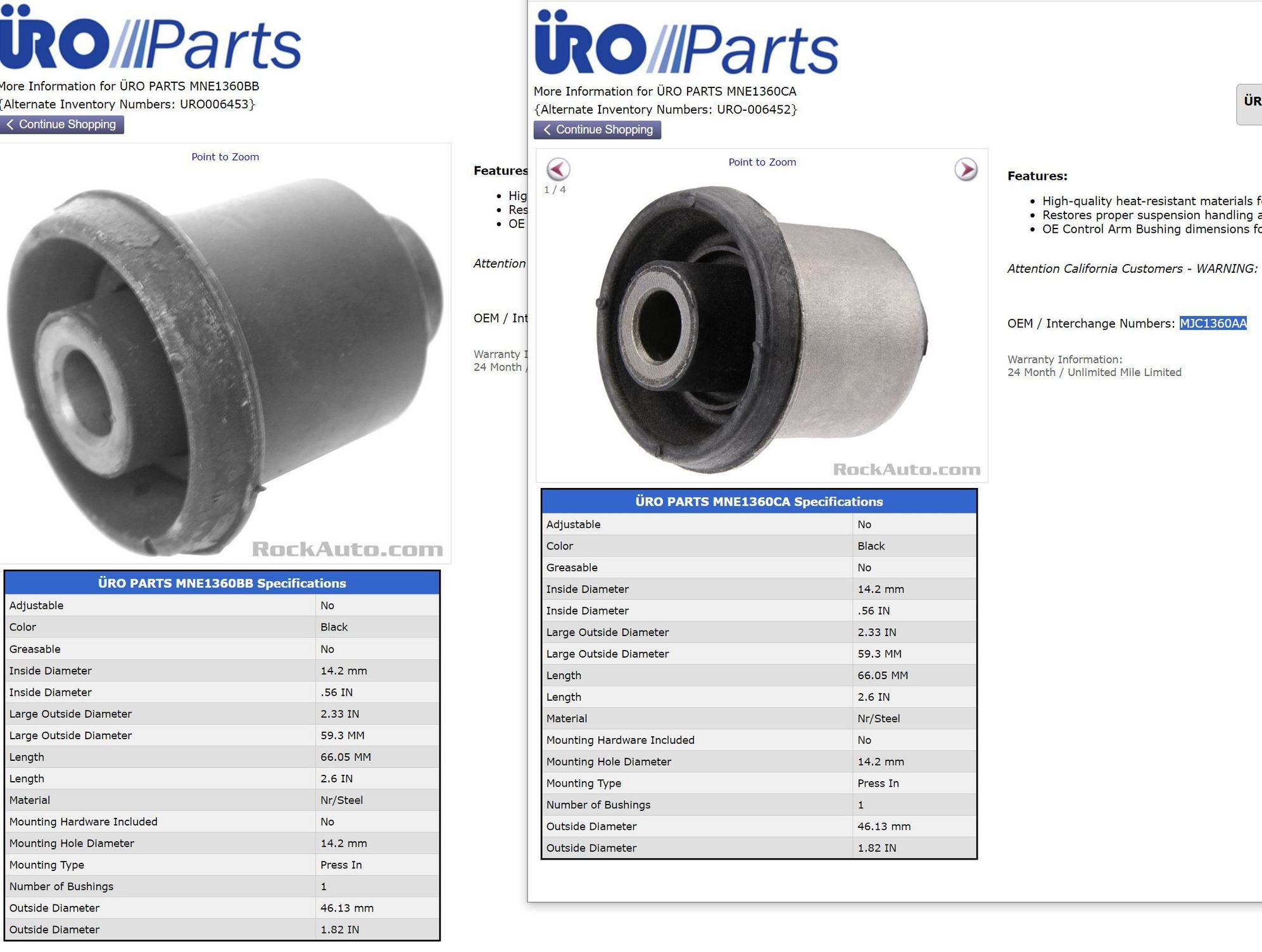

I bought lower arm bushes from Rockauto and they have VAICO V410028 list as front lower forward bushes.
However, when I look at the box that arrived, it has MNE1360BB below the Vaico number and this is the Jaguar part number for the front lower rearward bushes.
Are they okay to use in the front lower forward location, or should I ask for them to be replaced with MNE1360CA? What's the difference between the parts?
The URO parts info for both shows no difference in specs listed.

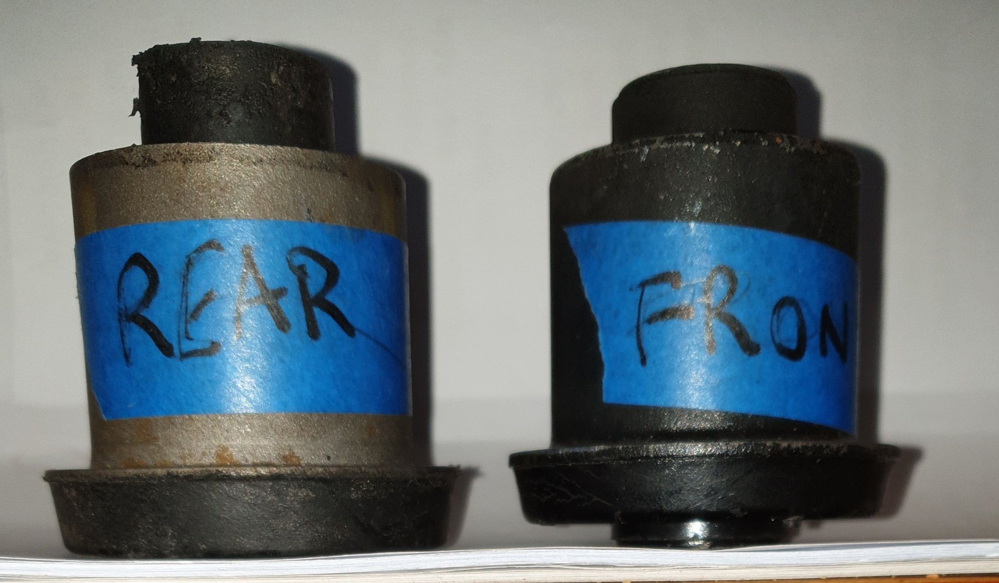

The basic dimensions of these bushes are the same but their position can NOT be swapped. The offset of each is different. If they are transposed the required caster setting will be unobtainable.

In your picture, which one is which? That'll let me confirm which one I received.
The next question is how to get the new one installed without damaging it?
sorry l didn't note which was which, here is a better pic.

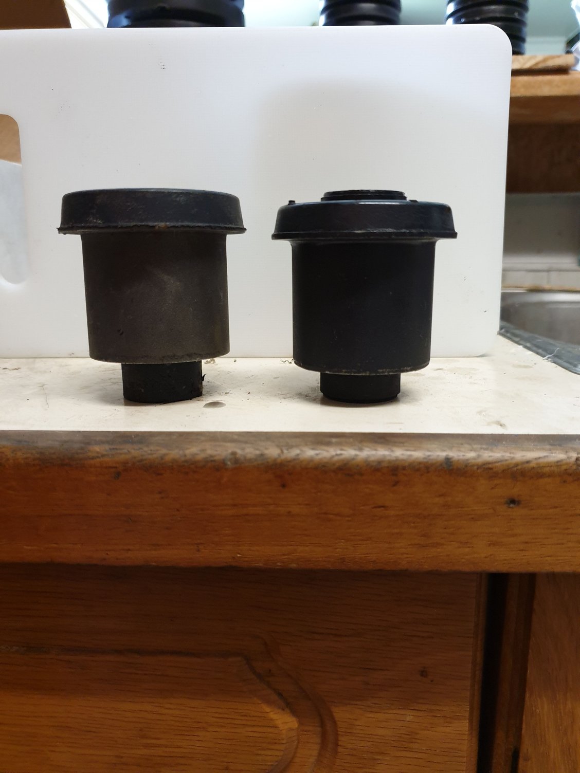

New parts arrived today. There is a clear difference in offset when you have them both together. The BBs I already had did seem to protrude a little, but the CA is significantly more proud.
I laid out the issue clearly in an email, with part numbers, and Rockauto agreed and sent a prepaid postage pdf via return email, so quite happy with that outcome, although it has of course cost me a week of lost time.
