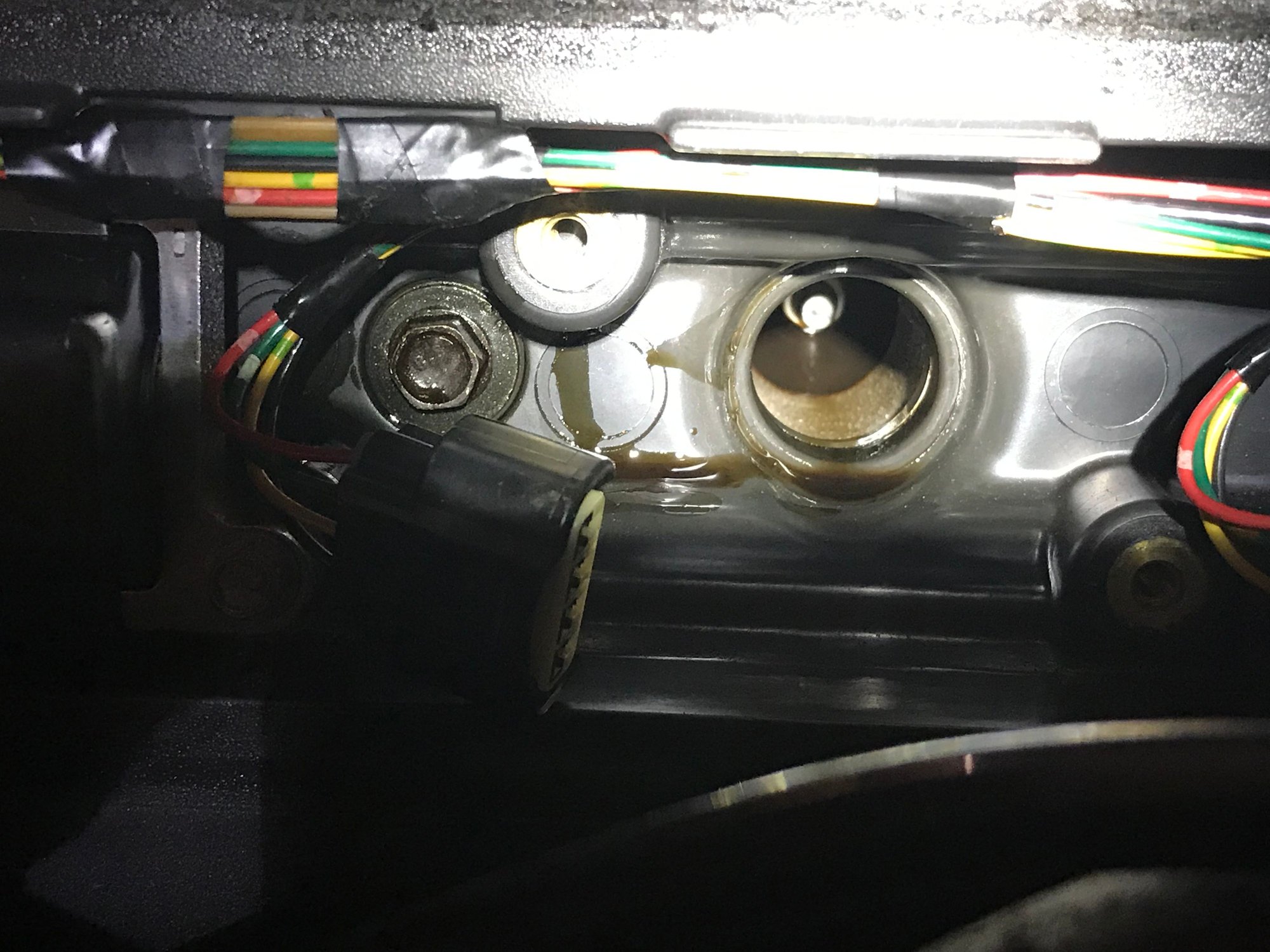

No I doubt it’s a good sign. I pulled the codes today. Had multiple misfires. I had already ordered new coil packs and plugs so I strayed pulling the coils and this is what I found. Lots of oil leaking down into the spark plug holes. I wasn’t totally surprised by this. At any rate this and the battery are going to account for many of my issues.
Now I will pull the valve covers replace the upper trimming chain tensioners and reseal the covers.
