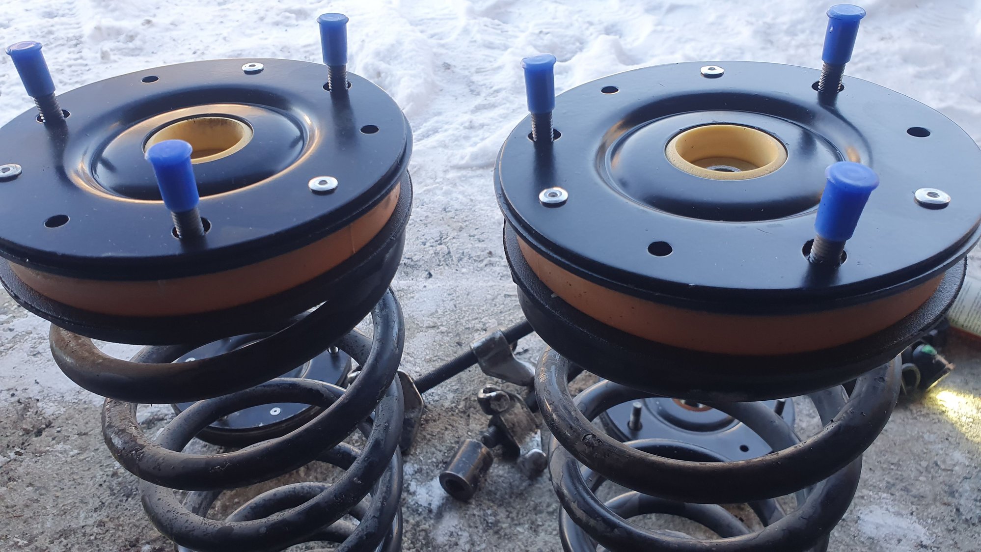

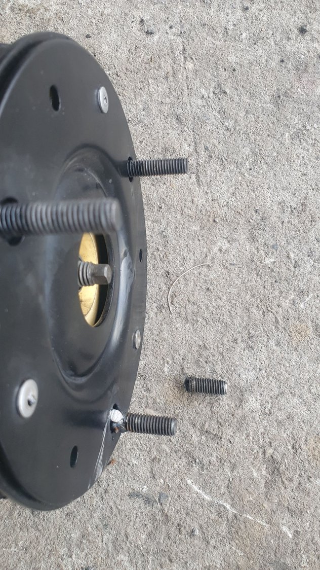

Now finally got things together.. but the upper strut mount I purchased from Germany was really crappy! On one mount one of the 3 bolts was Imperial treaded. Can you belive that??? In an attempt to use a 5/16-18 UNC nut the bolt came loose. Also on the other mount, one bolt came loose but managed to use locktite to lock it enough to fasten it. The one with wrong treads I had to cut off and weld on a new m8 bolt.
Just be aware that some supplers are not good. I have filed a compliant and I'm waiting for an answear.
New bolt Welded on
New bolt Welded on
The bad bolt
The bad bolt
The shitty quality mounts...
New bolt Welded on
The bad bolt
Ouch, sorry to hear that.
Looks like the original mounts are sitting on the ground behind the struts in the last pic. Don't throw them away.
And if you haven't mounted the struts back on the car yet, you may want to hold off and follow member baxtor's recommendation in this trail to order new inserts from him or member cjd77. Many users here will vouch for both.
Good luck!

Old Feb 15, 2025 | 02:03 PM
michaelh's Avatar
Posts: 4,798
Likes: 3,008
From: Jersey, Channel Islands
I really don't like the way some of the aftermarkets have the pop rivet heads proud of the top surface of the mount (cf OEM). This disc locates against what is essentially a flat metal surface, so something has to bend...
