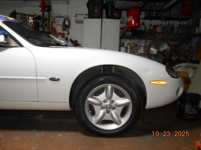

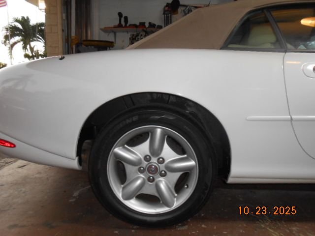

I recently replaced the shocks with new Bilsteins and new shock mounts from our fellow forum members.
I did the rears myself since a spring compressor was not needed. The fronts were done by my neighborhood Tire Kingdom and even though I marked the position of the spring in relation to the spring seat and gave them specific instructions on how I wanted it done, I have serious issues with the ride height of the car.
Right now, after putting 100 miles on the car, The rear sits at 16" from the center of the wheel to the lip of the fender and the front sits at 17" from the center of the wheel to the lip of the fender. As a result of the front being so high I have a lot of floating while driving at speed.
Now I am questioning whether Tire Kingdom assembled the spring/shock correctly. I spoke to them and they want me to pay them another $114 to check them.
Here are some pics of the car as it stands now.

Can you get some pics more specifically of the spring and mount assembly. Both top and bottom seats.

baxtor, he used my mounts in the front and yours in the rear.
I told him to get that height the tops could have been have put two on each side.
The top nut is showing 5 threads, so the washer is down to the seat on the shock stud. He did say he had 3 felt washer on the bottom seat but no way could they had that height.
Thoughts? Wayne

Hi Wayne, hope you're well.
At least another isolator thickness in there Wayne.
Rough calculation 15mm at spring lifts around 23mm at measured height point. (Rough measure)

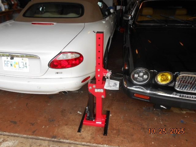

@ wayne and Baxtor: I came down with the flu so I was unable to do any work on my car. I am hoping to get back to work on the car by midweek. Rather than paying Tire Kingdom another $114 to disassemble/assemble the front springs, I purchased this to do them myself
New Strut compressor
I will get back to you as soon as I get my friend to come by and help me take things apart.

Sanchez, first off, look after yourself.
That machine will need to be adjusted to get the full throw of the springs of a Jaguar. Make sure you test the hold and install the chain every time. Getting the whole strut to set straight in there is a bit tricky.
As info, my car with new springs in the front is 15 7/8 and the rear 16 with a very good ride and control, so not so much of a worry on the rear but we need to get that front sorted out.
Take care and let us know how it goes.

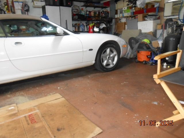

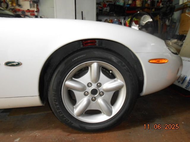

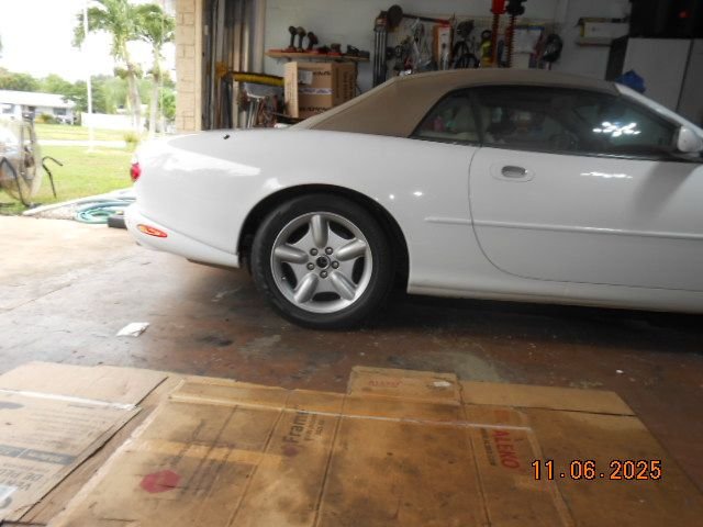

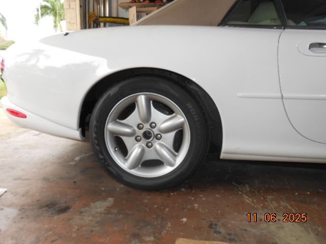

Update:
I finally got back to working on my car. Wayne and Baxtor. I forgot to take pics if the front and rear shock assembly before I took it apart. My apologies.
Anyway this is what I did.
1) lowered the car 1.5 inches all around with a set of H&R lowering springs with Wayne and Baxtor's top mounts. I had to shave a little bit on the circumference of baxtor's mounts the get them to seat properly.
2) replaced all the front bushings, upper balljoints, Lower control arm assemblies, swaybar links and outer tierod ends.
Once the job was completed I took the car out on the highway and for the first time since I got the car I was able to put it through a thorough workout to see how the car responded to highway speeds and (way above at times). Drove it for around fifty miles round trip and I had a smile on my face all the way.
The car responds very well to everything I put it through and with the lowered suspension the car felt as if it had the OEM springs on it. It was very smooth. I thought that with the lowered suspension I would get a harsh ride but that was not the case. Back home, I measured the ride height from the center of the wheel to the fender lip.
Front: 14 15/16" on both sides
Rear: 14 1/2" both sides
I am aware that the more I drive the car, the more it will settle and at that point I will make the necessary adjustments.
Here are some before and after pics.
Tomorrow, I am going to the alignment shop to do a 4 wheel alignment and get my tires balanced.
I want to see what toe specs are and also see where the camber is with the lowering springs.

Any and all comments and recommendations are welcome.
