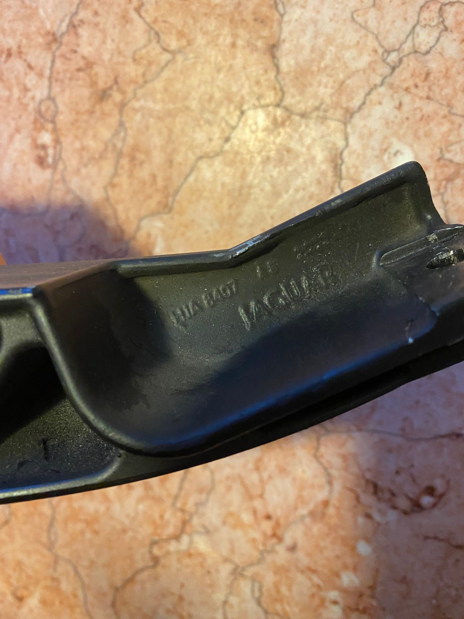

Hi mates, I accidentally tried to close the roof with the cover on, the result is a broken part... I believe it's a kind of cast. Now it's welded but I don't use it, afraid of breaking again. The part number is HJA8407 if I'm right, not easy to read out. (see pic) Do you have any idea where to get one? I dug every corner of the net but nothing.
George from Budapest/Hungary

Hello! My best advice would be to call Brian at Coventry West. They are our go to for salvage Jaguar parts. We also may be getting in a 1996 or97 Jaguar XK8 from a customer for parts. https://www.coventrywest.com/ Here is the website for Coventry West. They just might have the part you need! Best of luck!
