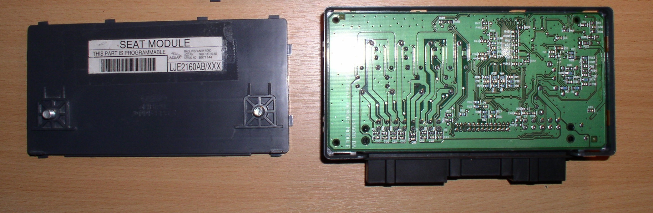

The one from my 2005 XK8 has exactly the same numbers:
You'll see the lid is marked 'THIS PART IS PROGRAMMABLE'.
Any equivalent module can be reprogrammed to your vehicle by the dealer but if you want to avoid having to have the replacement reprogrammed, make sure you get one from a vehicle which has the same options fitted e.g. 12 way Seat, Powerfold Mirrors etc.
Attached Thumbnails Passenger seat module-11a-passenger-seat-module-cover-removed.jpg
