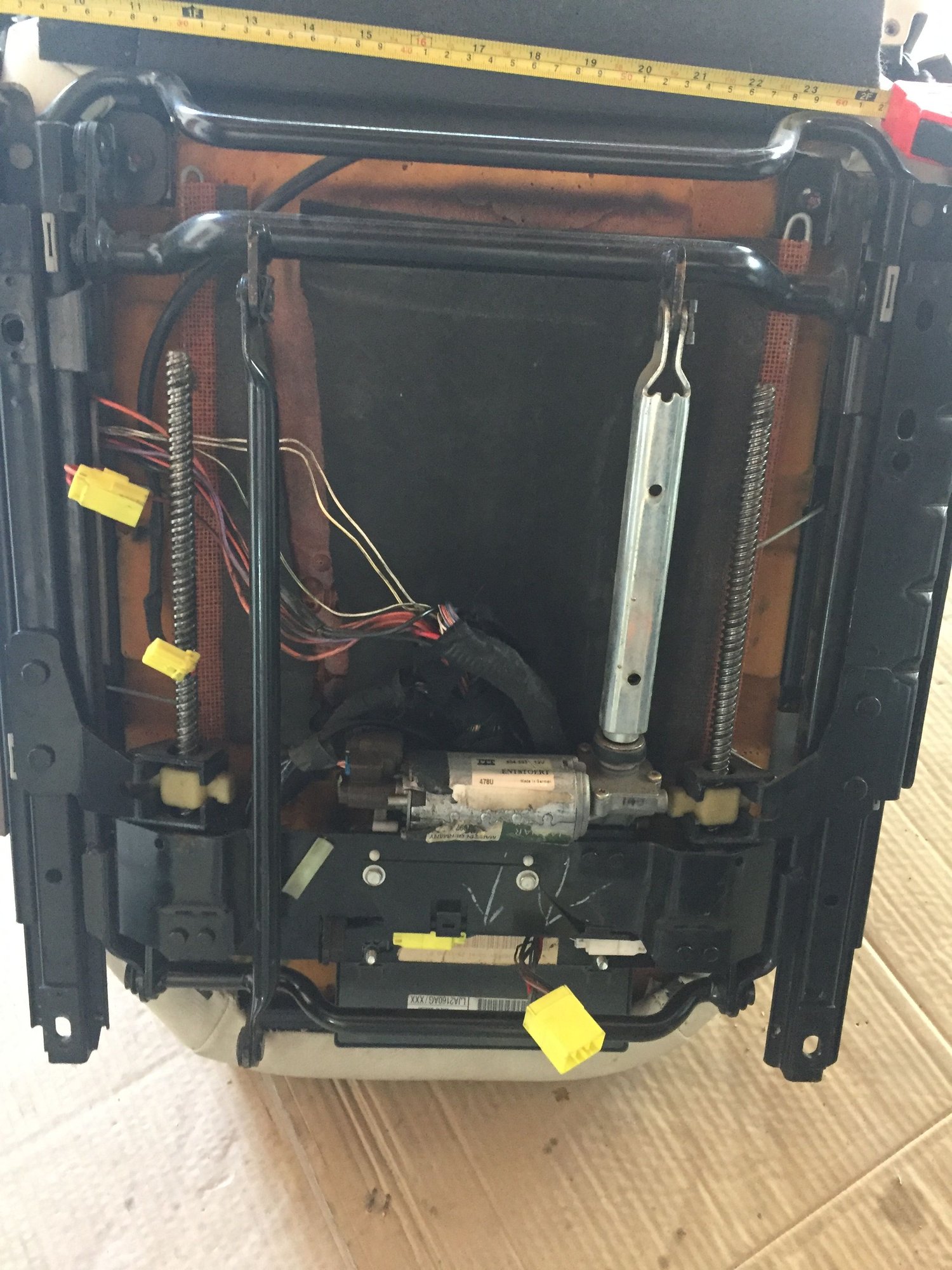

This is an interesting one. I presume my 99MY XK8 LHD in the Kingdom of Bahrain is a ROW car and it has a passenger seat bottom that does go up/down.
Here's a pic of the bottom of the driver's seat's mechanisms, but I'm not sure which motor/worm gears powers this function as I wasn't looking closely for this at that time. Maybe someone else can chime in on what to look for. DIY Getting the passenger seat out of the car was relatively straight forward, but heavy. If you need help on that DIY job, let us know. Sorry never got a pic of the bottom of the passenger seat.

I only see one motor. Does one motor do it all? All the motions?
can ignore, sorry
in old parts list I see Motor fore aft and Motor height so 2 motors
