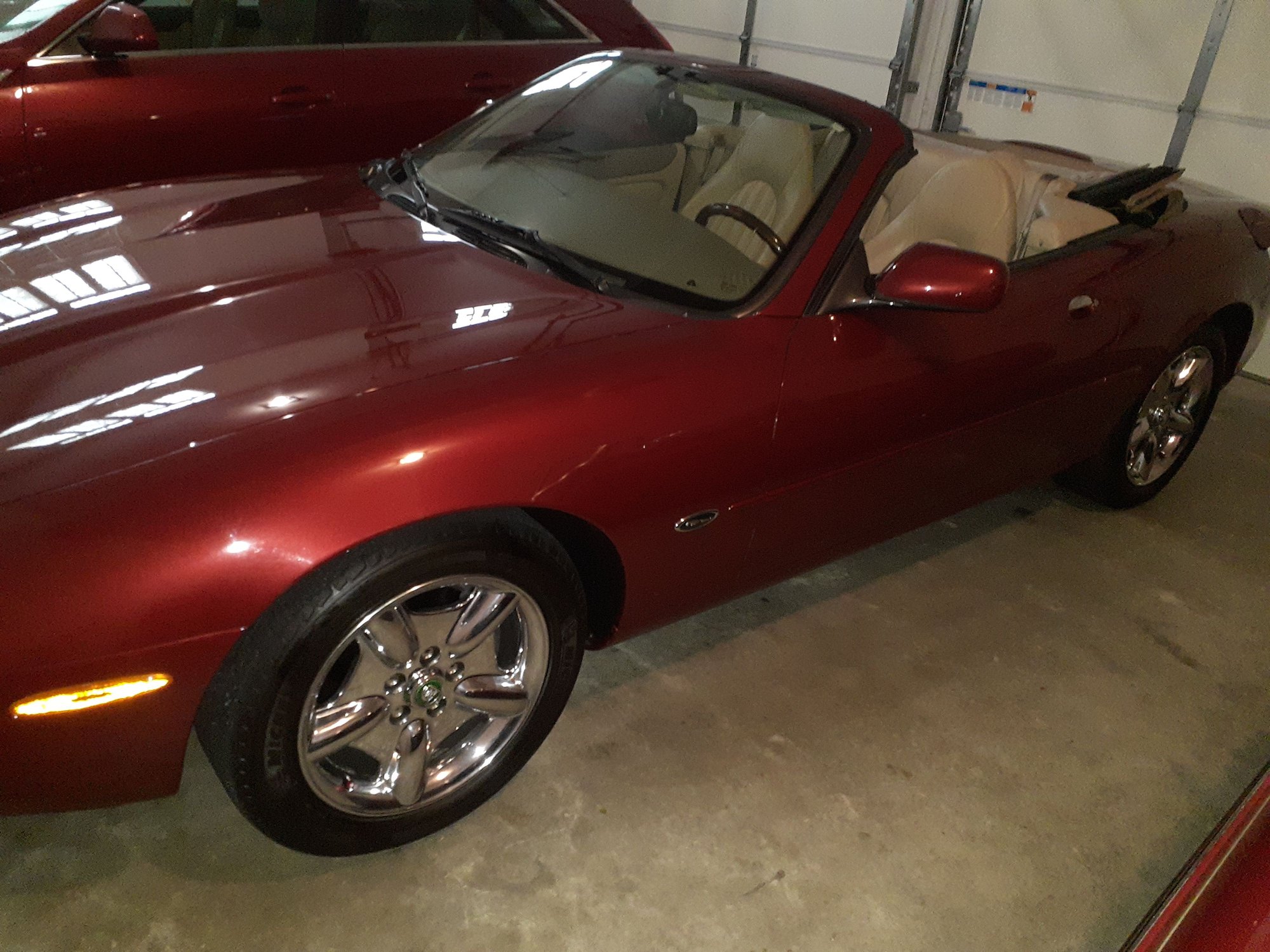

Proud new owner of 1999 XK8, 4L V8
I have just moved up from a 1980 MGB (staying in the British car family). I look forward to reviewing questions and answers here on the forum as I did with the MGB.
What are the common failures/issues with the 1999 XK8?
