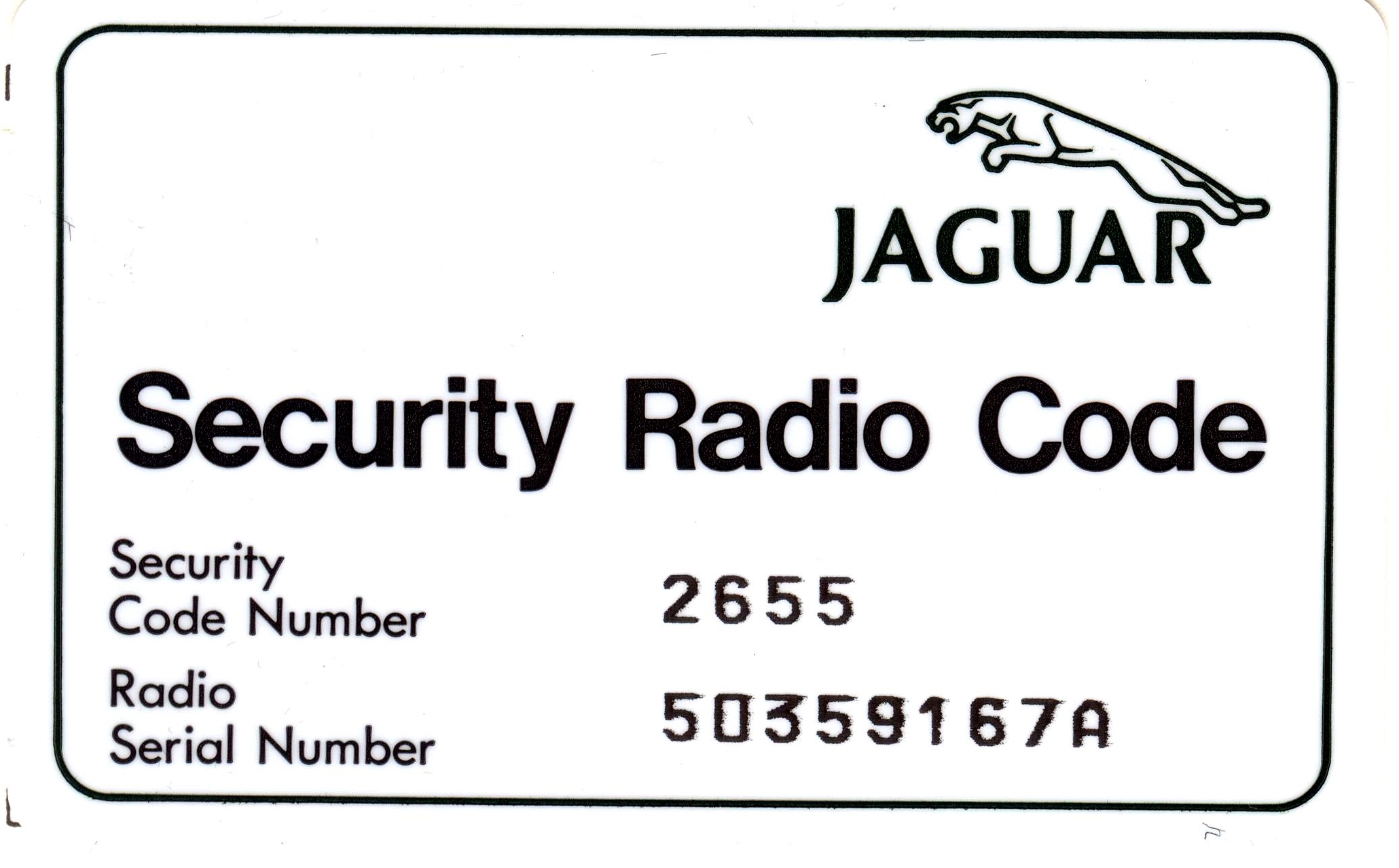

Very unlucky but not unknown to have a US spec vehicle with a coded radio. That makes only 6 I've read about on the forum at various times.
For those of us that have coded radios, the Vehicle Document Pack included two credit card sized radio code cards - this is what you're looking for:
Unfortunately this 4 numeric code is only any good to the present owner of my 2001 XKR Coupe wherever it may be now!
Even in the UK where all radios were coded, the code cards are frequently missing from used Jaguars. The Dealers over here usually look up the code free of charge. Provided the radio is the original, this can be done from the VIN.

No card.. ugh looks like a trip to the dealer...

7, mine. 'Have the 2 code cards and folder they come in. Radio also lost station pre-sets upon battery disconnect. 'Happy to say the car started after a month being asleep as if it had been driven yesterday. Nice kitty..
