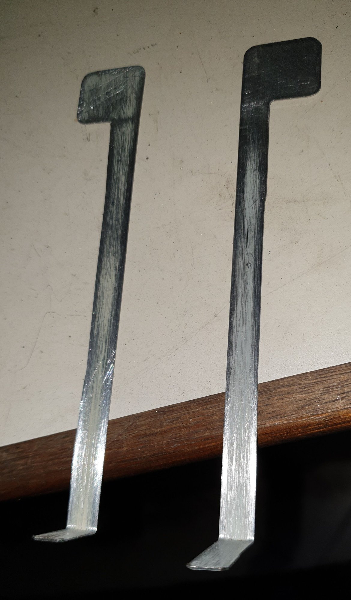

Get yourself a little sheet metal (around .5mm thick) and make a couple of these tools.
Move shifter into D insert tools above radio facia line and you can have radio out in 5 minutes.

@baxtor , is the tool you show about 6" long?

The one shown is 140mm but 150 or a bit more would be easier to manipulate.
l will put some pics up in a new thread because it really does save a lot of work in the removal process.

@baxtor so with those - you don't need to remove the center console and all the trim?? I have a set from a Mercedes I replaced the head unit it - now to find them and get to playing around
l just put another thread up with a little more detail.
the tools shown in pic on this thread do need a little change to shape at the big end.
