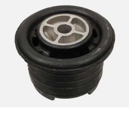

Hi
Still on this job.
What is the best way to get these main bushes out?
Thanks

They are usually glued in with epoxy. Assuming A-frame is out, I suggest you cut the centre out or press it out leaving the outer remaining (similar to front wishbone bush removal). You may then have to cut away the rubber and sheath with combination of angle grinder/ dremmel and chisel!
I guess that most of us tend to replace the A- frame and bushes at the same time, so, less experience around on removal. I guess the shop uses a 60t press. Good old ebay g-clamp, anvil and lump hammer have always shifted the most stubborn jag bush/ ball joint removals - plenty of threads on forum.
Also, when refitting, rehearse it as the recommended epoxy is fast setting. I used a 6t press but it was a bit to close for comfort on my own. Got there but only just.

If a press is not available, then progressive destruction of the bush is a slow, but effective method of removal, though I cut back the rubber lip and drifted it out. That needs firm support and a big hammer!
When I did this job, it seemed to me that the use of quick setting epoxy, as recommended in Jaguar's manual, was principally to shorten the job time in the dealer's workshop. As I was using two thick mahogany boards, one on top of the bush and one under the frame, being pulled together by two suspension spring compressors and this being a slow process, I used 24 hour setting epoxy to give me time. It all worked as planned and neither bush has moved during the five years of regular use since then.

burn them out with a propane torch

I drilled the rubber out. Worked very well. Plenty of videos using this method on youtube.
