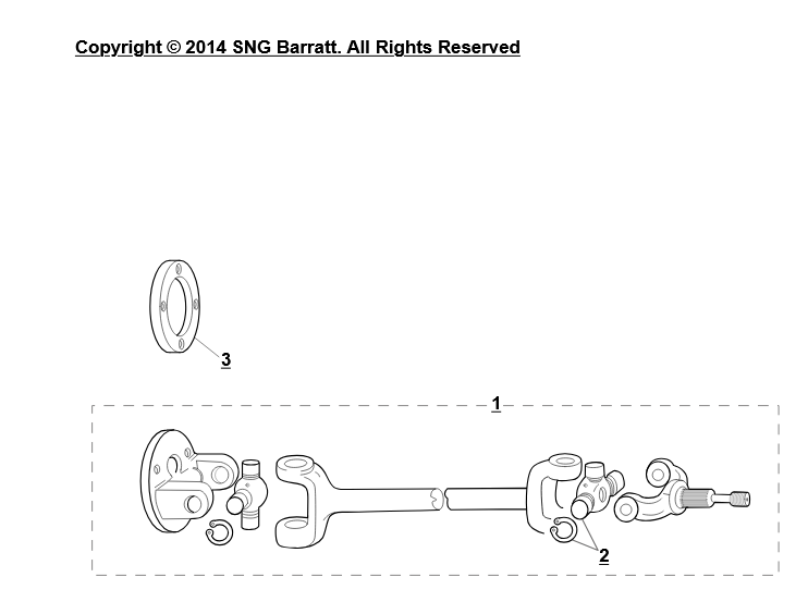

Oddly, Rockauto doesn't show the diff/hub axle UJs for MY2003, but does for the earlier cars. The JEPC shows the same part # (as noted by chirpy) for all cars.
Old Mar 11, 2026 | 06:17 PM
Chirpy's Avatar
Joined: May 2016
Posts: 173
Likes: 129
From: Castle Rock, CO
So assuming you want the universal joint(s) for the half shaft, i.e. part 2 below:
Using Jaguar part number JLM1388, which is the OEM part number, supplier choices include SNG Barratt, Moss Motors, Jagbits, etc.
for Rockauto you have (use the search function, or look up any XJ6, e.g. 1996 XJ6 Vanden Plas):
GMB 2150178, FVP 2100178, FVP 2150178
Noting that the listed dimensions in the ‘info’ details match 1350 series universal joint
(in which case I would probably go for Spicer 5-178X, since I find Spicer parts to be good quality)
Please double check using your own research before ordering, in case I fat fingered something.....
yrs i want part 2 in the diagram below.the shop is calling them cv but i call them universal joint
