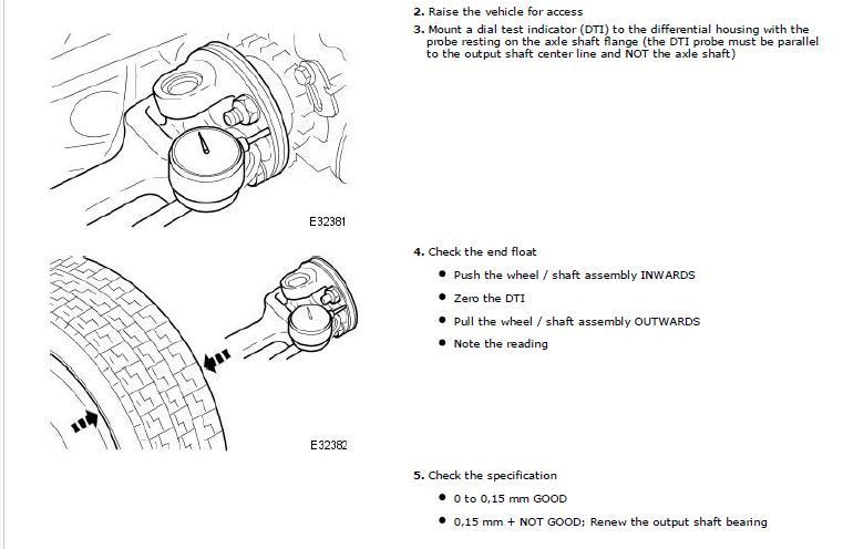

Here's the end float specification from the 2003-2006 Workshop Manual. Note that 0.15 mm is 0.0059 inch, and the spec for earlier cars was 0.006 inch.
Cheers,
Don
