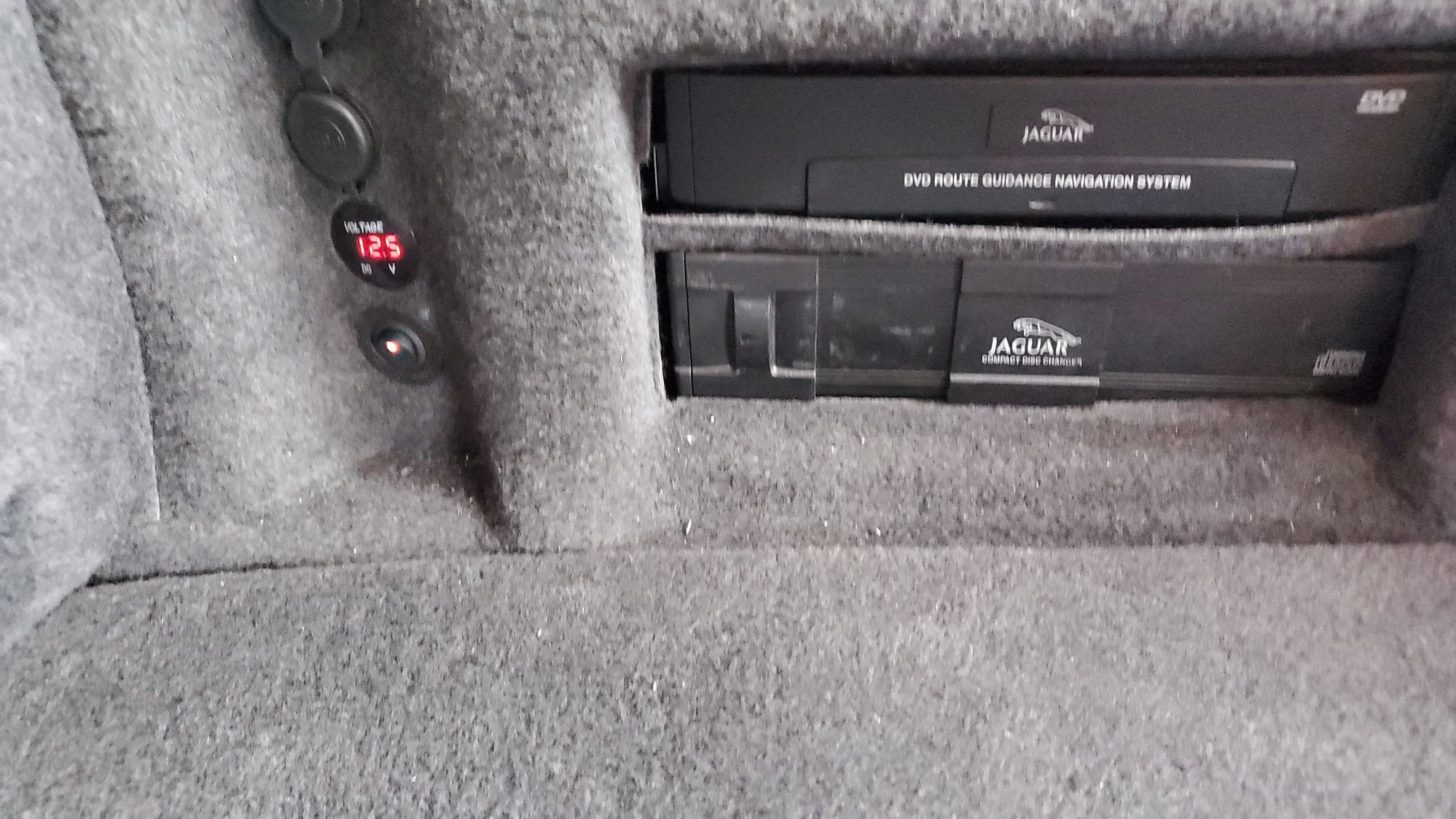

Has anyone removed the CD Changer on an XK? I have the Navigation head stacked above the changer, and above that what looks like a pre-amp. It is all screwed down in a rack with out of the way screws.

Sam I have removed mine a few times. You can get to the hold down screws, but 1 warning: Be slow and careful feeling around for the rear screws - there are razor sharp edges back there. (Guess how I know:-)).

I used a small 90degree offset screw driver to get to the screws

There’s a pedestal type stabilization bracket in back of everything with a nut holding it down on a small stud, iirc.

Not familiar with the Nav unit, but I found it easier to remove the entire rack with all components still mounted. You can see the 4 bolts holding it PLUS there is one hidden down behind in the Qtr. Pnl. that requires a longer extension. After removal, I cut a slot to allow the bolt to be installed and the mounting bracket to slip under the installed bolt. Do not think I would ever got the bolt talented blindly. Tilt the assembly in and then back, the hidden bolt slips in, the other 4 holding the assembly are visible. Worked for me.

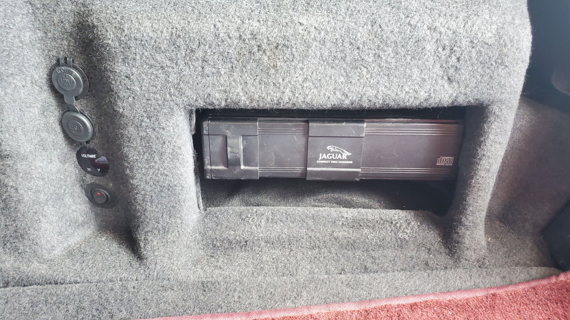

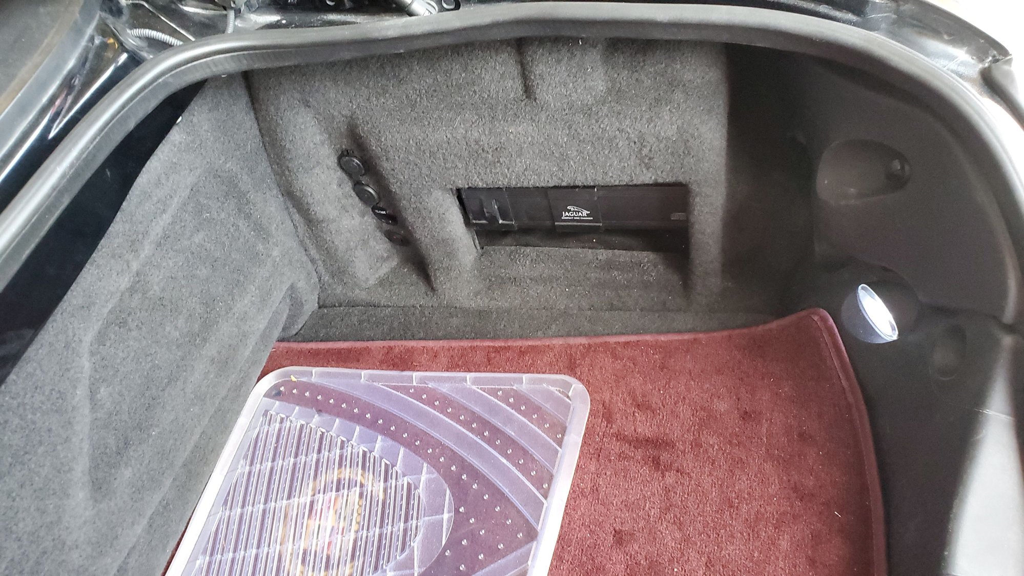

I managed to get my CD rack out with only a few minor cuts(no ambulance required). The Nav unit was not required as I had changed out to full gauge display. When I purchased a used CD on eBay, it came with a Harmon-Kardon amp that I thought I might use, but did not find a power plug(only the small push in connector receptacles. Now I have an H-K amp sitting around looking for a home.
I reinstalled the CD changer, and my original amp, at least 3 times to get it right. ended up with a space below the changer after I moved it up into the Nav unit previous location. I filled the excess space with bubble wrap, and covered it all with black velvet. Now I have storage for a couple of CD magazines. So far so good.
