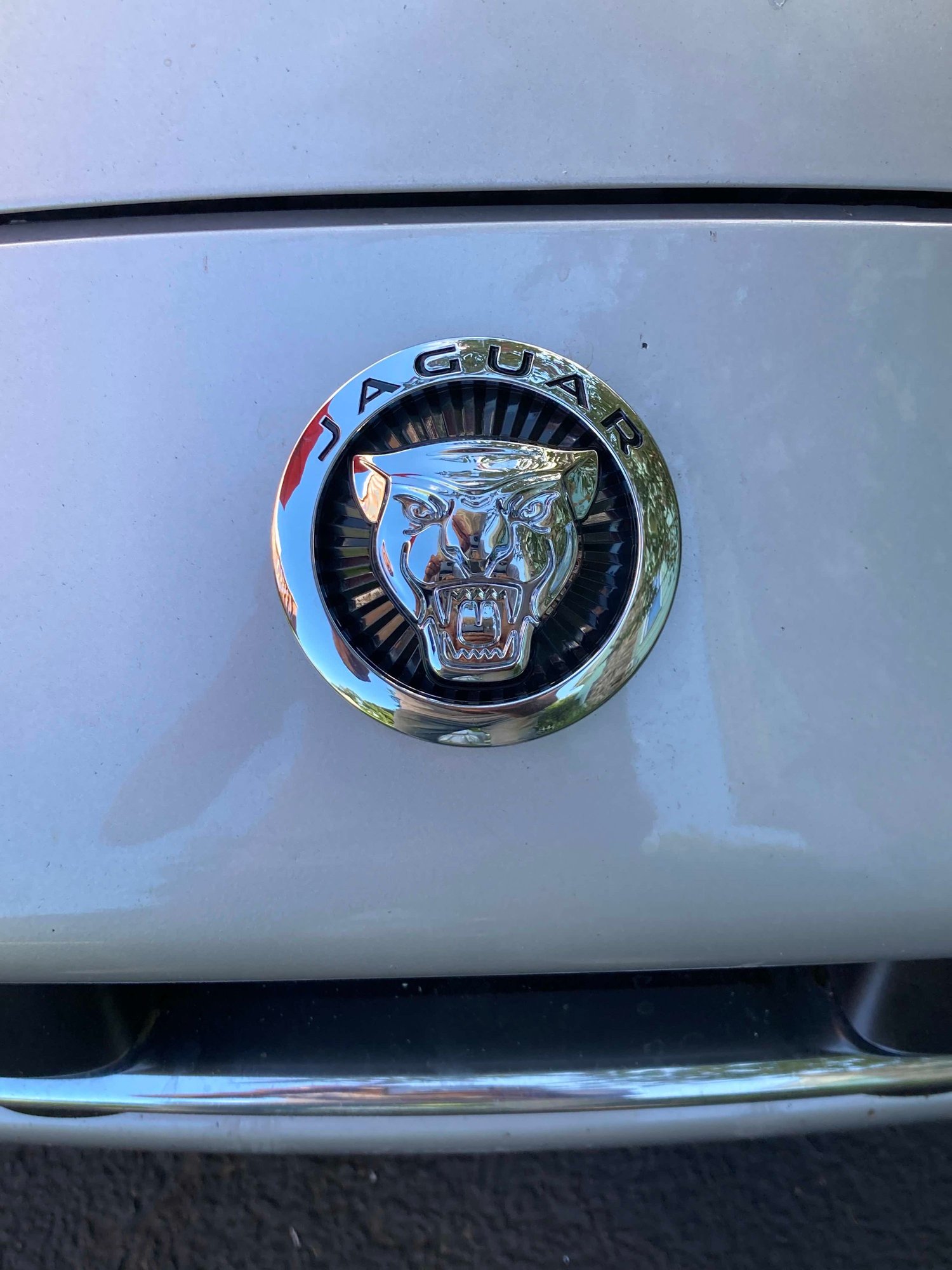

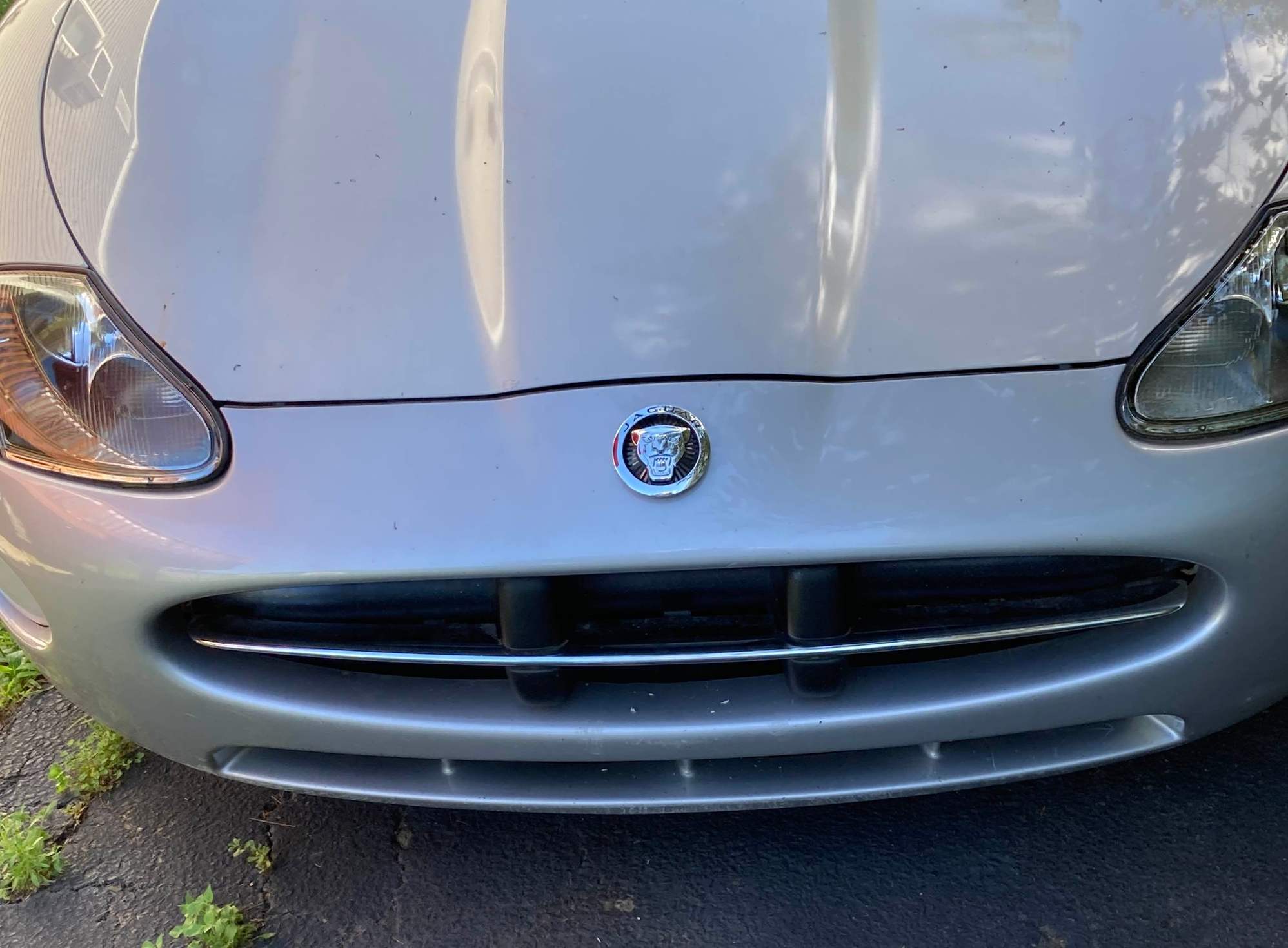

Noticed last week that the growler badge was missing from my front bumper. Don't know if someone popped it off or the adhesive gave way after about 18 years. Here's a challenge: Try to find a used OEM replacement for a 4.2-liter under $250. I couldn't. In fact very few used 4.2 badges are out there. And of course, they're out of production. Not wanting to drop that much on a badge that night get lost again, I opted for an Amazon knockoff intended for an XF. It doesn't say 4.2 and at 3.8" is larger than the original, but for $22 I can live with it until an affordable OEM shows up, if ever.
Removing the old badge was easy and difficult. Easy because you can cut through the adhesive with fishing line. Difficult because the badge has a plastic center post that goes thought the bumper cover and is held by a compression fastener that does not want to come off. I gave up trying when I realized there was no reason not to use the center hole on the remaining base of the badge as a guide and just drill thought the center post. I forget which bit shredded the post but i started real small and worked up a few sizes and the badge came loose.
The new badge had locating posts that needed to be ground flat so the adhesive would have a good surface to adhere to. It is a bit thicker that the original (which makes it even easier to steal). Below are a couple of shots of the end result. I'm not necessarily loving it, but not exactly hating it, either. It'll do.

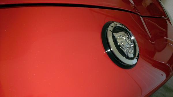

I did this about 10 years ago, except I made a bezel for it too. More details are here.
Originally Posted by Stamford
