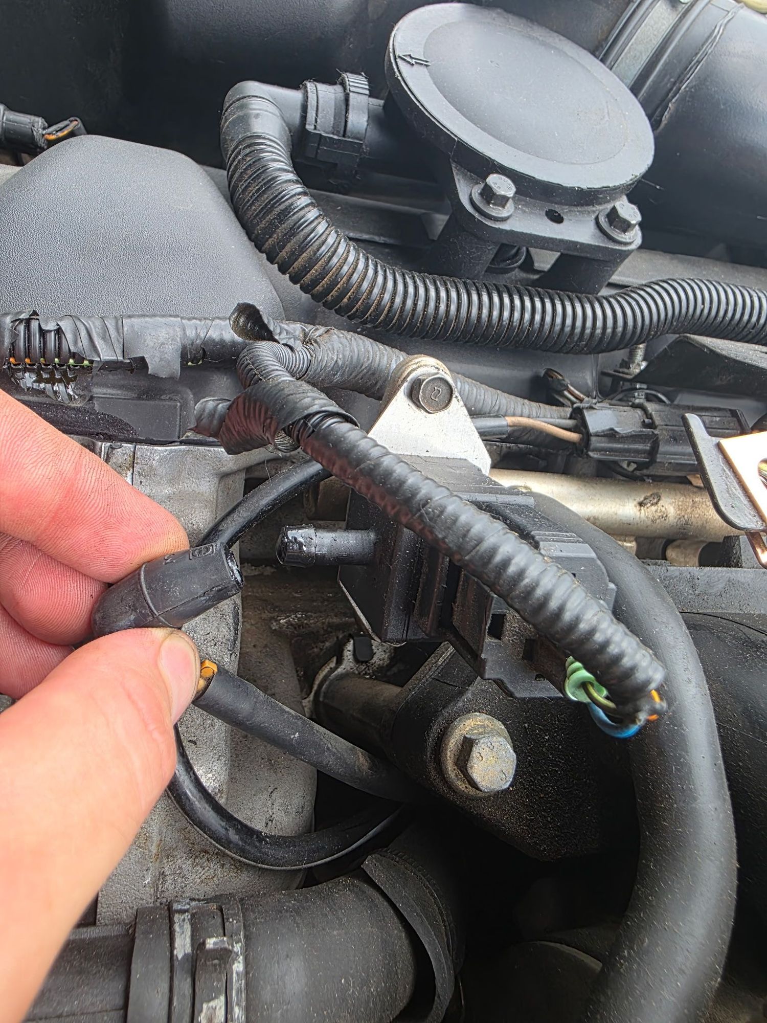

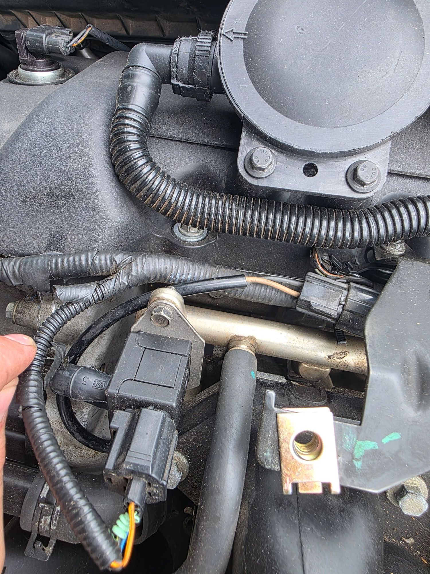

The symptoms were caused by the fuel pressure regulator rupturing which was allowing gas into the vacuum.
New regulator installed (surprisingly inexpensive) and it works like a charm!!!
