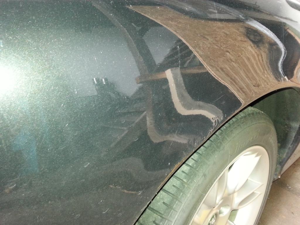

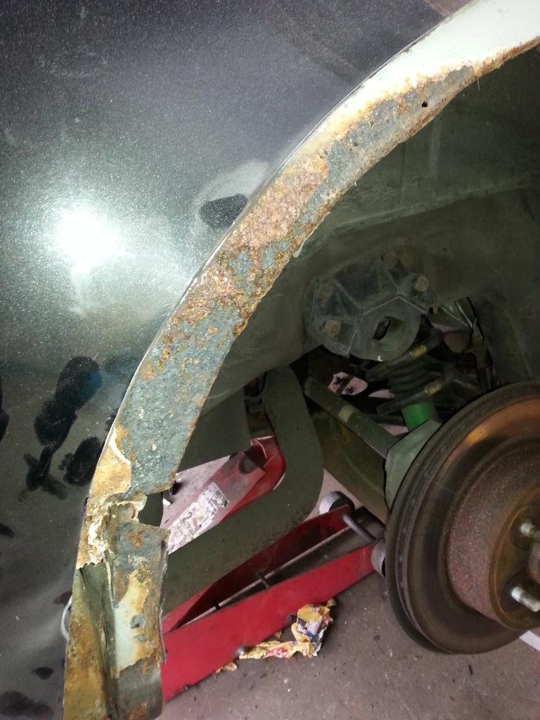

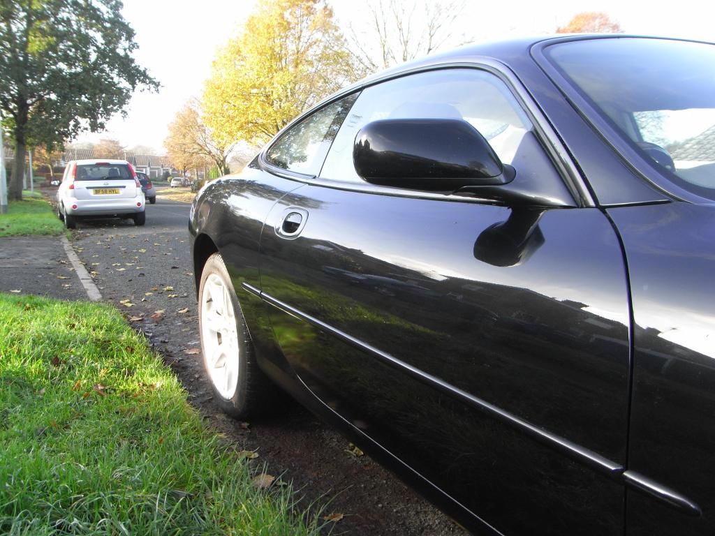

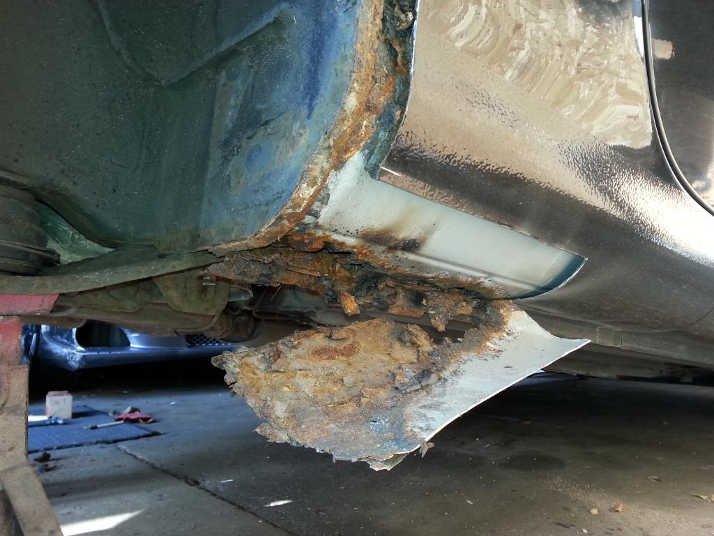

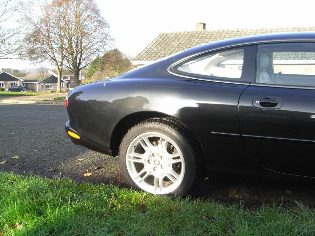

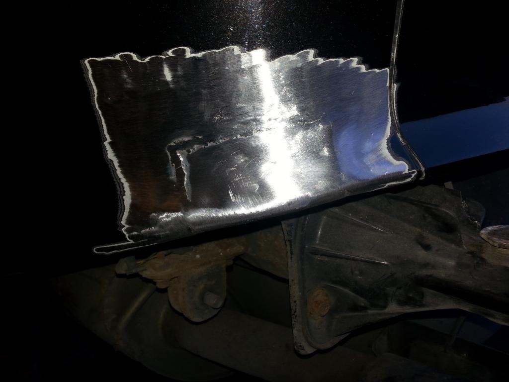

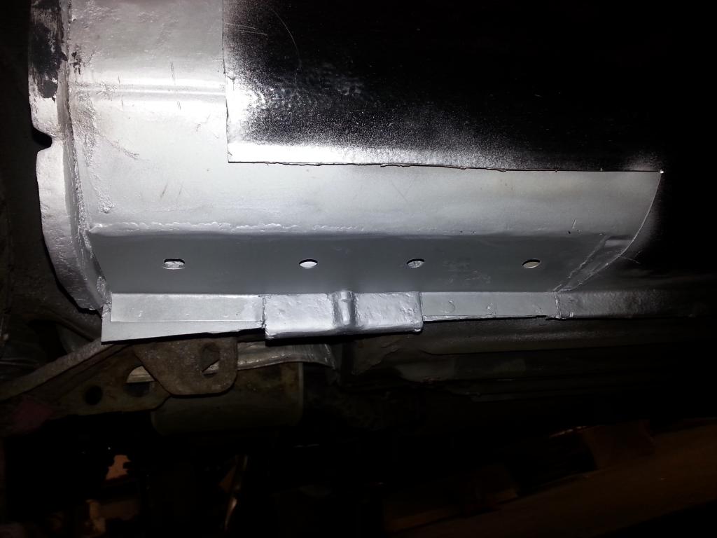

If you run an XK in the UK, you might not wish to read any further! My 2001 XK8 had developed a few bubbles around both rear wheel arches and close to the seams on the rear quarters. I thought about tackling the work myself, but given the compound curves at the rear, anything less than perfection would show in the finished results. Living only about an hours drive from XK Racer, I thought it best to trust the work to an expert: I'm glad I did!
What follows are the photos taken by Tony as the work progressed. They are self explanatory and need no further description. The final photos were taken today and show the finished result. It is all now protected with Waxoil underneath and in the cavities.

Thank you all for your kind comments. The credit goes to our own XK Racer who did all the work. Not only did he do a great job, but he kept me informed and supplied the photographs showing the progress.

I'm sorry to say there was no filler, it was just rusty metal. From the outside there was not a lot to see other than a few bubbles, although it was a little more evident on the offside. Unfortunately, it was eating away the metal from the inside, leaving the shiny paint largely intact on the outside.
The wheel arch repair panels are the new panels recently introduced by SNG Barratt.
The front floor pans still need attention, but this is a job I will do myself.

The inner wheel arch panel looks like it was made to measure on a stretcher, nice. Time I bought a shrinker/stretcher.
I have a single paint blister on the top of the wheel arch on my 450SL, once I dig into it I am sure I will need to do the inner and outer section like yours above. I have aftermarket outer arches but will need to make up inner repairs myself.

I would like to say this was the worse I have seen....... But alas not.....
Funnily enough as I was doing Renaulvations XK I had another customer show up wanting exactly the same thing but his was beyond financial repair.... Sure if you have a sentimental attachment but I had never seen an XK so bad..... The car had in excess of 180K miles, was an 8 no real redeeming features and would of cost many thousands to fix..... His one saving grace was somebody had reversed into his front wing, this of course wrote the car off, I suggested he take the pay out and buy another......
