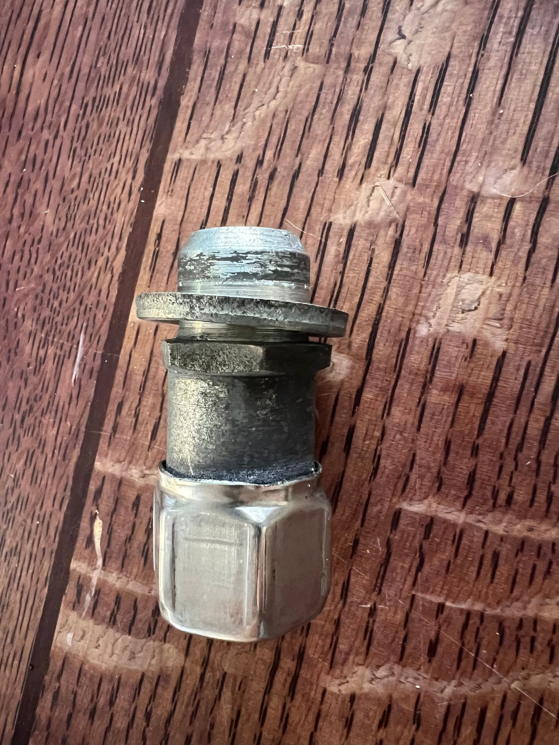

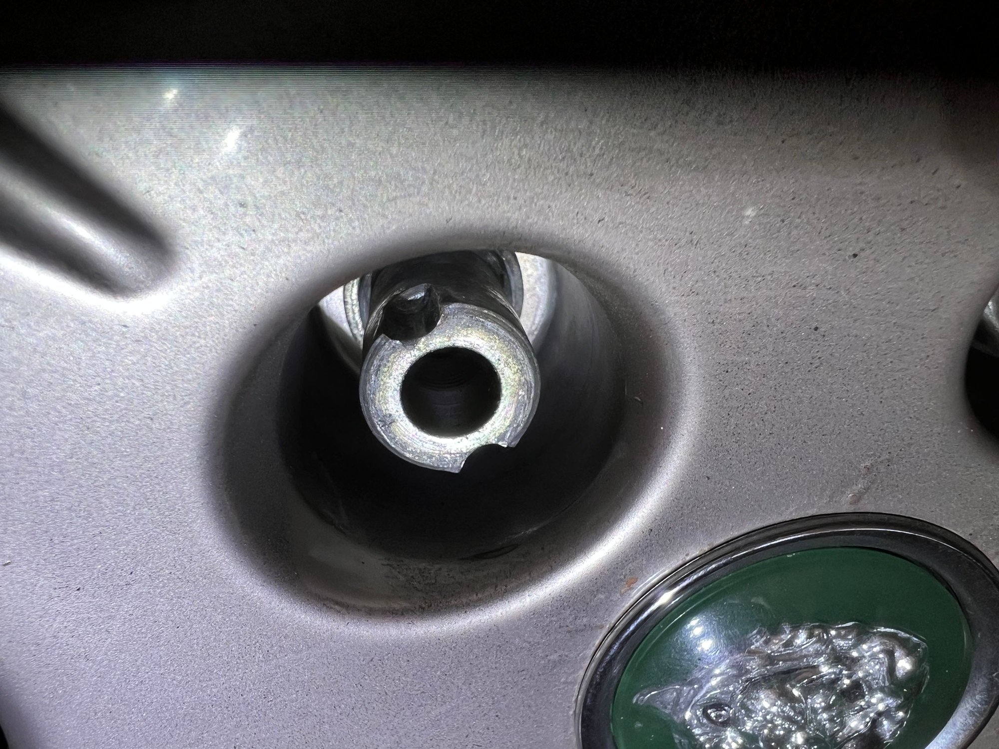

Dumb of me not to foresee or check for this but today realized the wheels have locks and I do not have a key.
Just wondering if anyone recognizes them as being OEM or just one of the million types of random aftermarket locks I'll never find?

That looks very similar to what I have on my Detroits. It has a cap that covers it with a fake key slot.

Thanks, that sounds like exactly it. Helps narrow my search dramatically. I did just hammer on a socket and was able to remove the one wheel I need one now. I will probably just toss them if I can get the other 3 off.

Wow these are really turning into a p.i.t.a. - very unique lugs as far as I can tell. The beveled face is inset into a secondary bore, and a washer on the outside of that bore. Very very specific it seems. So far can't find anything like it except for replacement key set from Adamesh. I supposed my lugs are all in good non rusty shape so I can stick with them - even though I know I'll inevitably lose the stupid key myself some day.
I can't even really determine which surface is the primary surface holding the wheel on - the cone or the washer. Or is it supposed to all deform a bit and both engage.
I can't even find the plain stock lug nuts... has anyone been able to find a source for them? Pic attached:

For now, I found a new set of the OEM locks from adamesh for < $40, and mine will only be a fair weather car anyway, so that should be fine for now. I was able to get the existing ones off hammering on a 12 point socket, so this should be OK.
