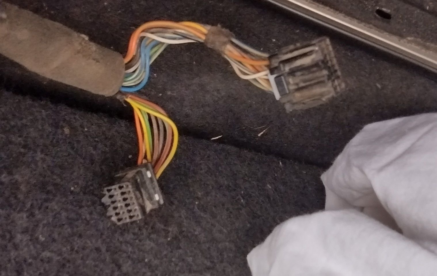

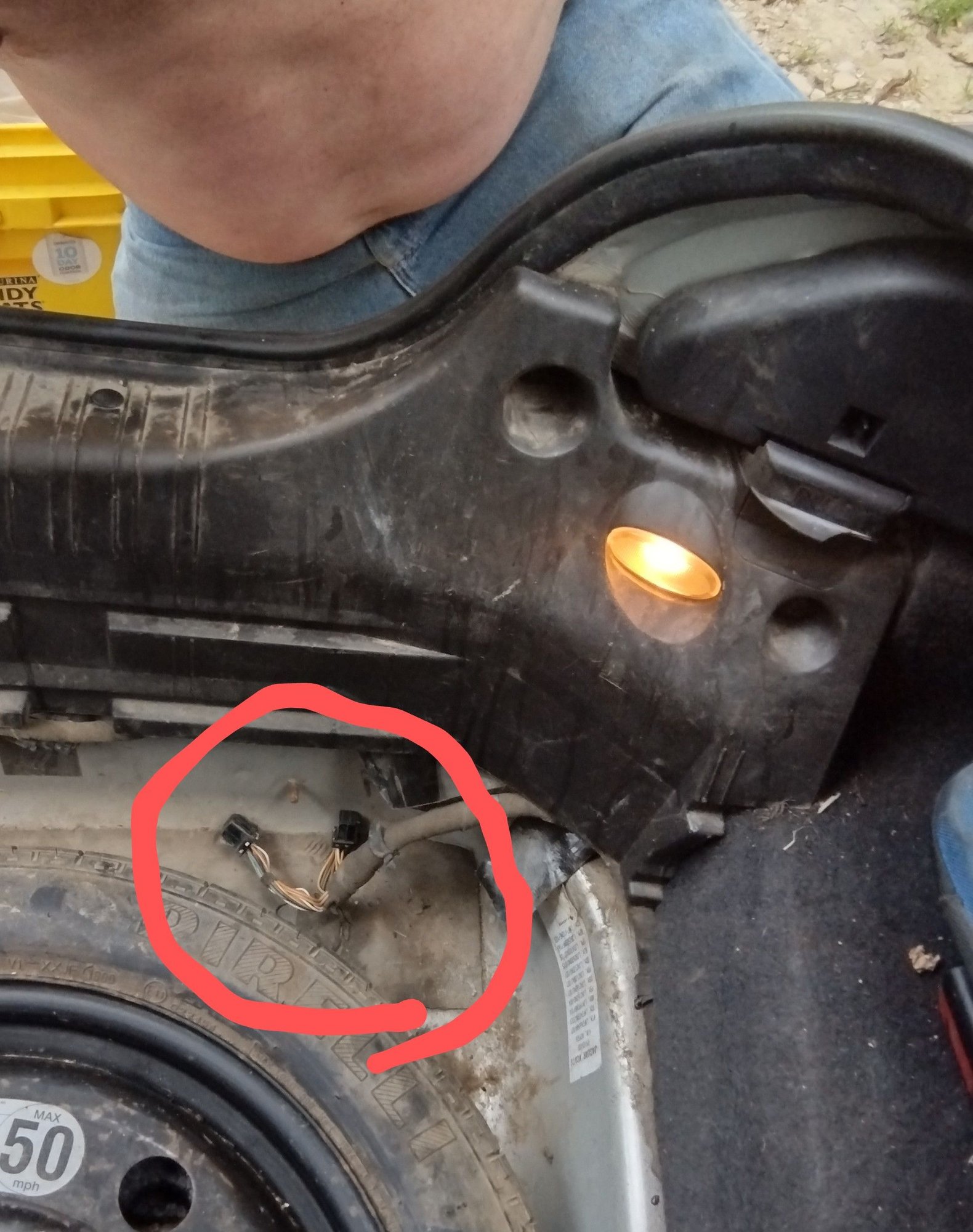

On my 2000 xkr convertible there are two connectors, 12 pin and 16pin, in my trunk. Looks like would be for a module. It would have mounted to the left rear of spare tire. Anyone know what these would have connected to. I've only found a 97 manual. It and everything I've found doesn't have anything there. Please and thank you.
Circled in red

That is for the telephone control module I think

The telephone module is behind the rear seat cushion. Those wires are for the reverse park sensor module -which is missing in the photo.

Too many connections for the parking aid module. JTIS shows its location rear LHS of boot/trunk.
...but only for MY2000
