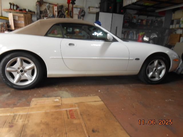

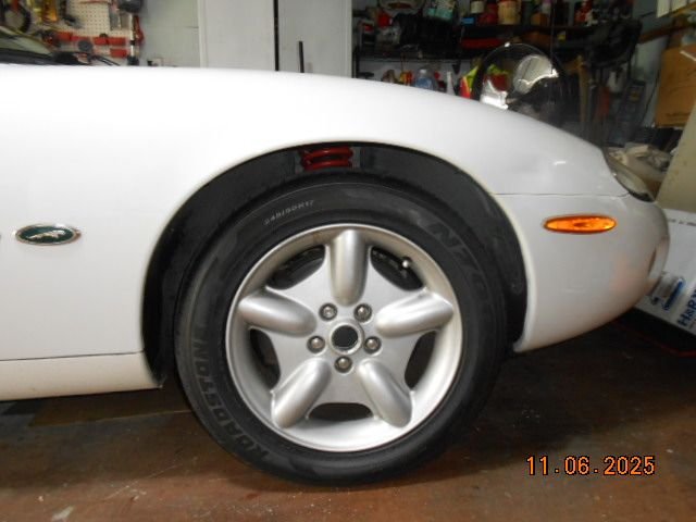

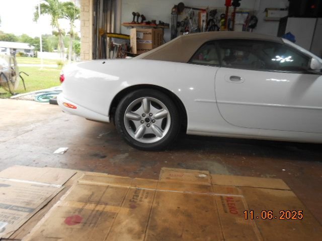

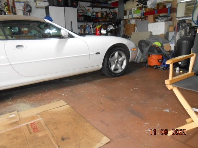

I just finished doing a full front suspension overhaul and added H&R lowering springs to my 2001 XK8.
A few weeks ago I installed a Joying stereo system and mover the triple gauge setup where the OEM radio used to live.
Tomorrow I go to the alignment shop to see what needs to be done to correct any camber issues associated with lowering the car
Poor pic but it shows the screen for the Joying stereo and the gauges moved to the OEM radio location
this is what the stance looked like before lowering
These are the after pics

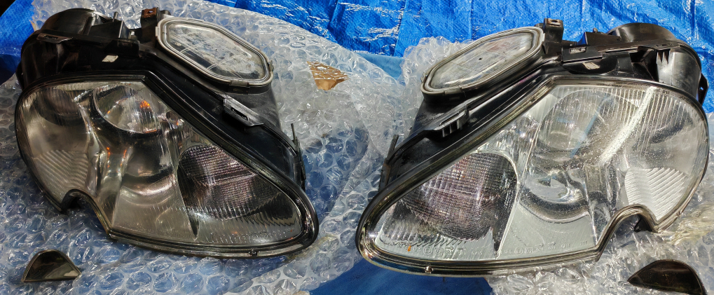

Not something I worked on today, but something I bought online arrived today:-
A pair of headlights complete with the often lost and hard to come by washer covers. I think spares like this, which can't be 3D printed, are going to become harder to get hold of and insurers are going to want to write off the car rather than replace a broken headlight after a small shunt in a car park.

Just a private seller - I'm not sure where he got them from, but they were in original Jaguar spares boxes with the correct part numbers, but clearly had been used (and advertised as such). I paid 450 Euros (about 530 USD) for the pair, which seems like a fair price here in Spain. I've seen a brand new one advertised for 3,000 Euros, which seems a bit of a premium over the used price. Hopefully I'll never use them, in which case I'm sure they'll appreciate in value more than the car.
I think your car needed a bit more than a pair of headlights unfortunately.

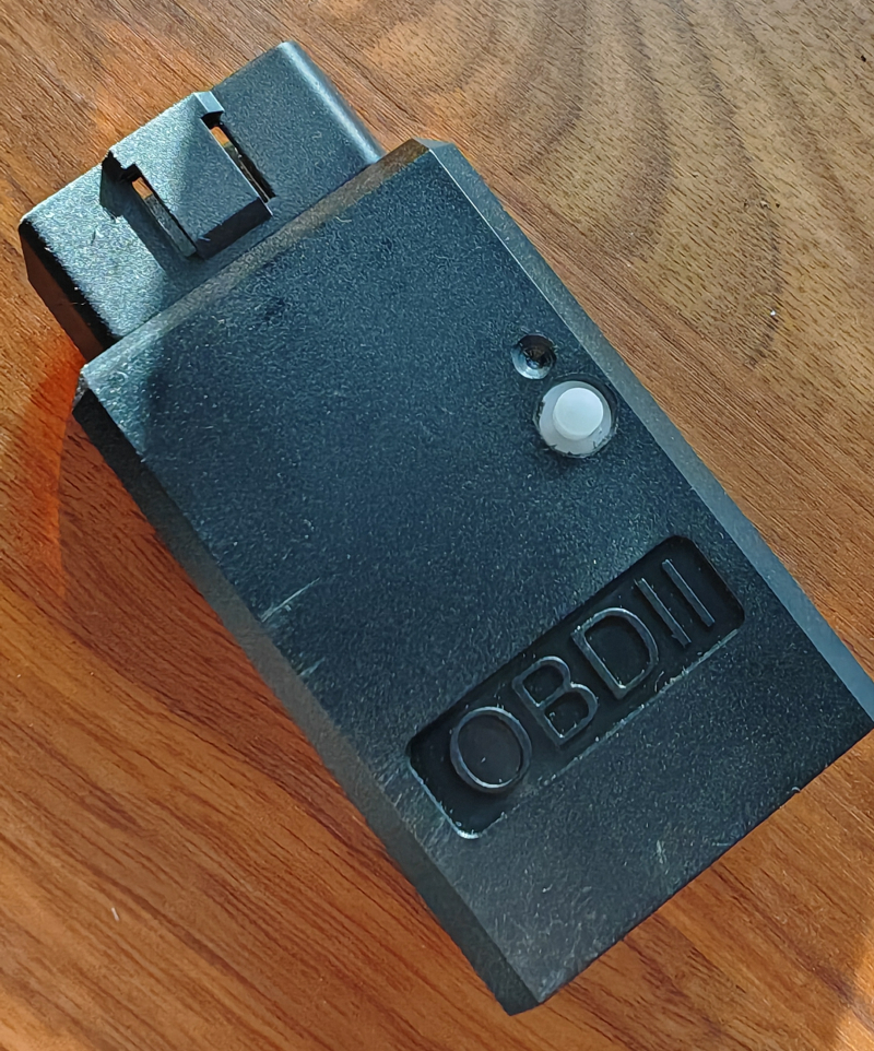

Today I rewired my OBD dongle to come on with the ignition, rather than being permanently powered when plugged in.
The standard OBD spec only has permanent power and ground (which is why the dongle stays powered up with the keys out), but Jaguar also included ignition switched power and ground on the vendor option pins - pin 9 is Ignition II battery+.
I also added a push switch to manually switch the dongle off when not in use.
This is a handy little mod if you don't want to be plugging and unplugging your dongle to save the battery, but only do it if you are 100% confident in your soldering skills as those pins go straight to the computers on the car.
