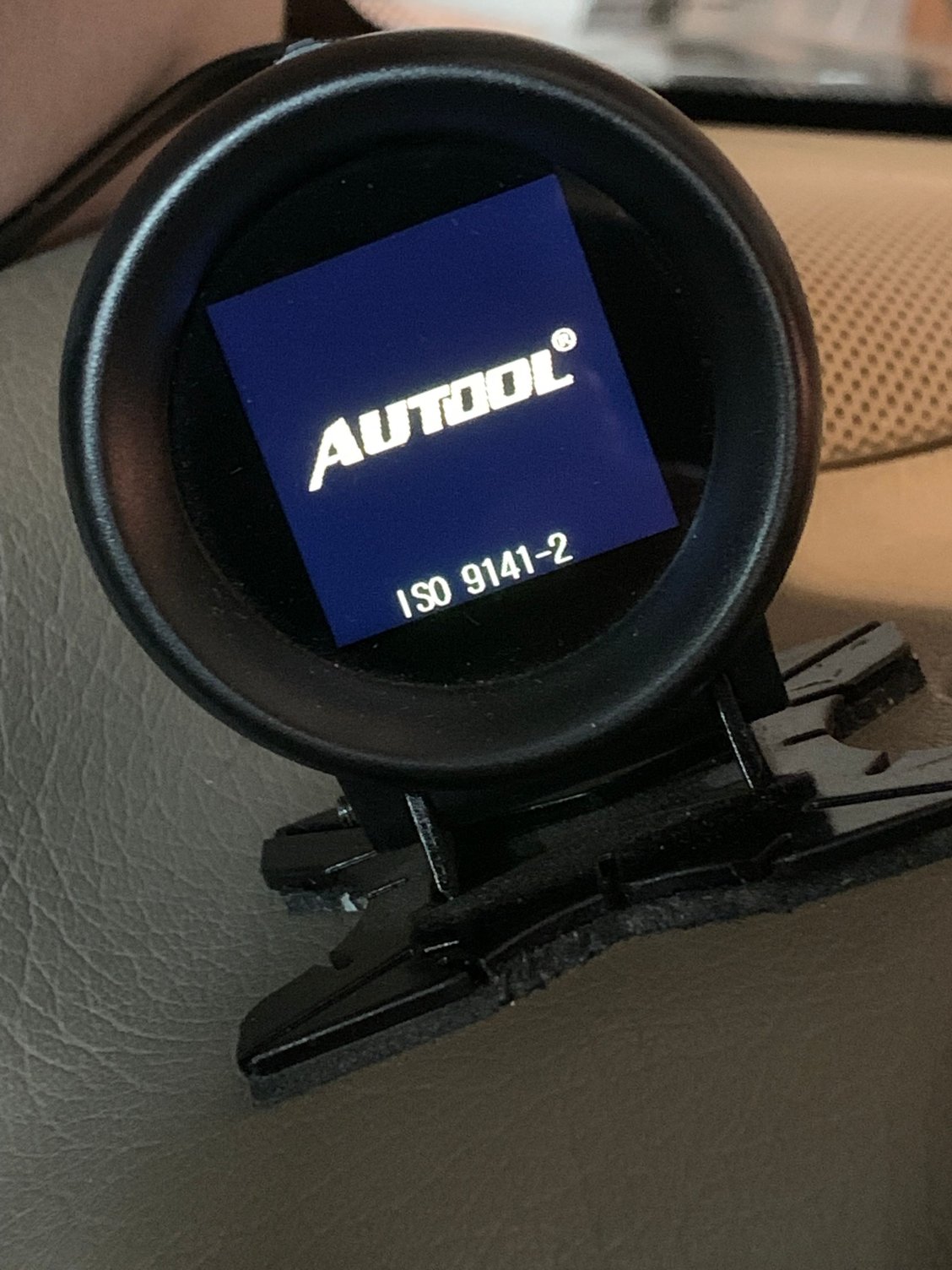

for what it’s worth, I have one of Amazon sourced OBD-2 multi gauges that sits on the left hand edge of the dash and is plugged in all time. It shuts itself off when the engine is not running (and draws no current).
it’s been plugged in for about 7 years so far….

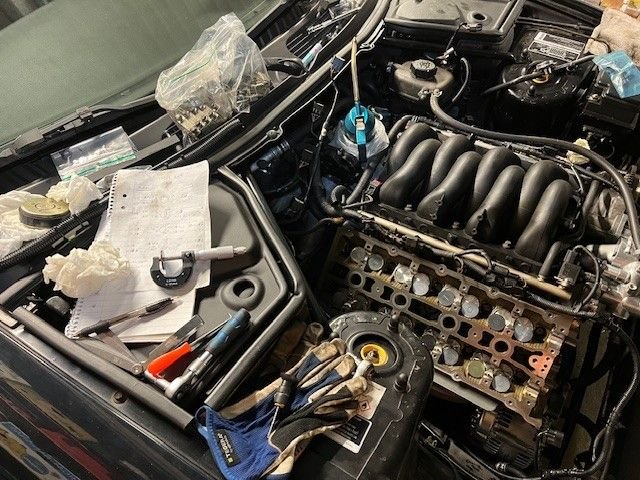

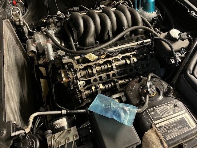

This winter i have spend some time going over the engine with replacing all chains and tensioners in the front, while there i also went through the ordeal of measuring and adjusting all valve clearances. Quite time consuming but worth it in the end. First i measured all valve clearances with a feelergauge... then i got uncertain if the cheap gauge was good enough, bought a new better one and redid it all, got uncertain again if i recorded it well enough, shorted the feelergauge to the (unprotected) fuse next to the ABS unit and welded it shut, bought new feeler gauge did it all again.
Removed all cams and measured all tappet shims with a micrometer, made records, cleared the rh bank as good enough and are now pondering over the results from the lh bank measurements... l guess maybe 3-4 tappet shim will be replaced since the clearance was a tad to much off.
-Its easy to think that if the clearance is on the upper limit that the heat to the valve stem will make it a little taller and close that gap and bring it in to tolerance, BUT, the cylinder head gets hot too, moving the cam away a little.. so i believe the net "gain" is not more than maybe 0,01-0,02 mm.
Fingers crossed, "Gemitus" (misery) will be back on the Swedish summer roads again in 2-3 weeks..

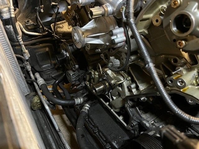

New water pump, front end open (what a struggle to get the steering pump bracket out of the way)
Measuring all tappet shim. (the little suction cup to pull the buckets out, speaker magnet to pull the shim off bucket)
LH side awaiting for its turn.

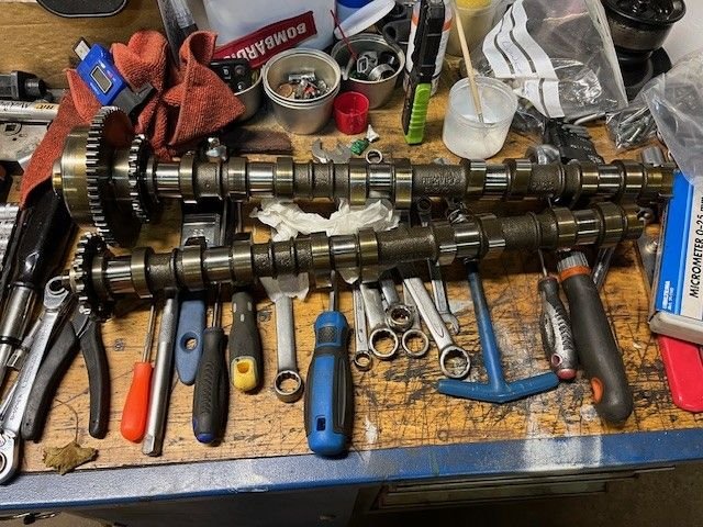

Cams.. measured all lobe lifts..

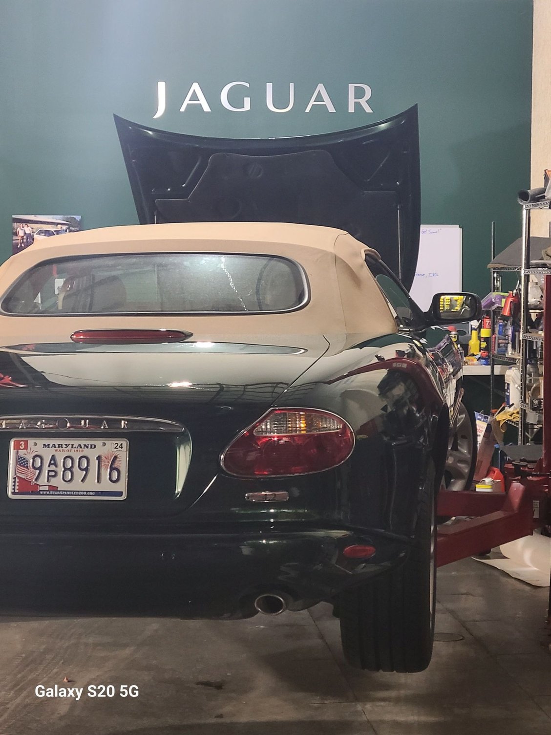

I recently set up a little corner of my business shop to work on my Jags. It's still a work in progress. Yesterday I started on a huge list of items on my XK8. The first of which is the shock mounts. I managed to get the assembly out on the drivers side. Let's just say the other side will go much faster! As I was closing down the shop I looked over and saw this view. It was certainly a kodak moment.

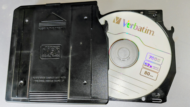

Today I found a spindle of writable CDs in my shed, so naturally I downloaded some music and burnt a cartridge worth of CDs.
25 years old and works perfectly - I'd forgotten what a big step forward boot mounted multi disc CD players were over tapes - takes me back to the 1990s.

Oh yea definitely, I actually went crazy and bought load of CDs again from bands I love, mostly "top hits" and collections and loaded my CD changer. Oh the memories. It is one of reasons I love old cars.

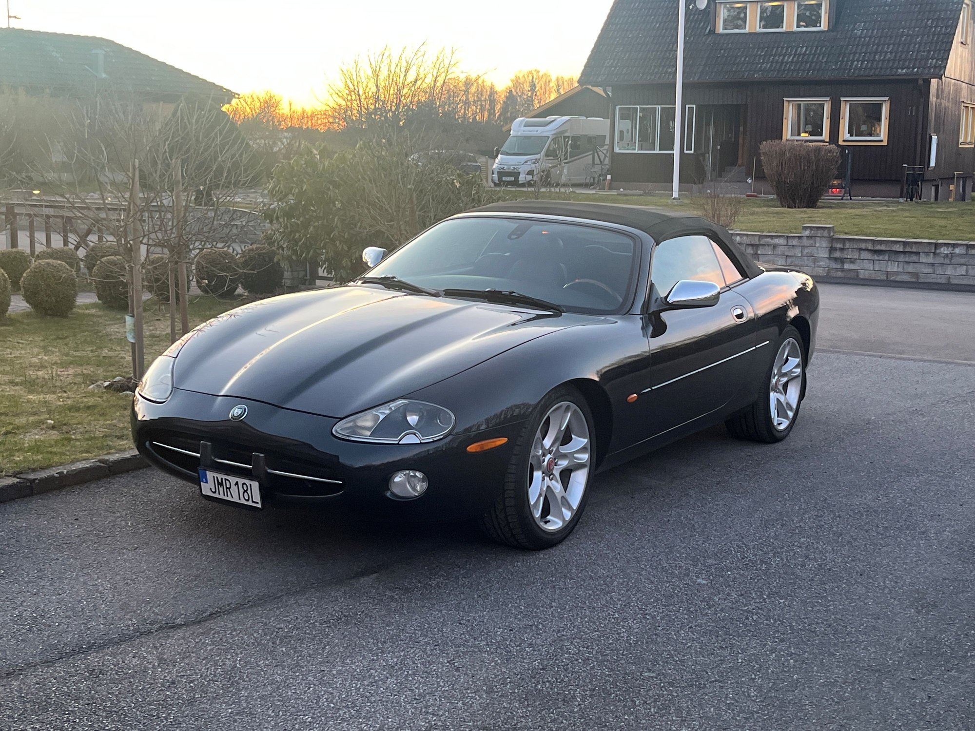

Finally got "Gemitus" through the MOT with no remarks, everything just fine.
But.. (somehow there is always a "but" when it comes to these cars) the one second rattle is still present.. and considering all the work previously done on the engine, im 100% certain its the VVT actuators that are making the noise.. and that is a bummer.. I have not yet read anything about anyone been able to get rid of this just replacing the VVT solenoids..
Anyway.. are now engaged in replacing both door lock microswitches.. ordered home a few different ones to try out.. fixing the anti rattle rubber strips at the same time..
