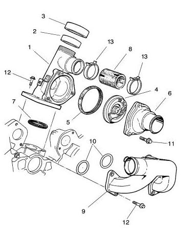

Like test point, I'm puzzled by the shape of it. The ones you've been looking at on eBay probably look like Items 1 to 3 in this:
What Model Year is your XK8?

You have a 4.2 litre normally aspirated engine? The JPG I attached to my earler post was for the 4.0 litre normally aspirated engine. This is the one that regularly fails and is available as a metal alternative.
The original plastic one is on the left and the aftermarket aluminium replacement on the right.
Yours is completely different:
what is this thing? 04 XK8-xk8-thermostat-housing-4.2-ltr-normally-aspirated.jpg
I haven't seen these as yet available in metal. Is that a split where the orange coolant staining can be seen in your photos?
