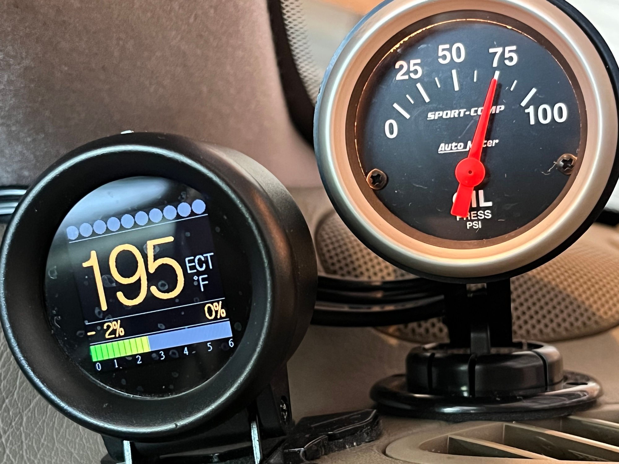

once the engine is fully warmed up, my oil pressure is about 30 psi at idle and 75 psi at rpm’s over 1,800 regardless of which viscosity I’ve chosen.
